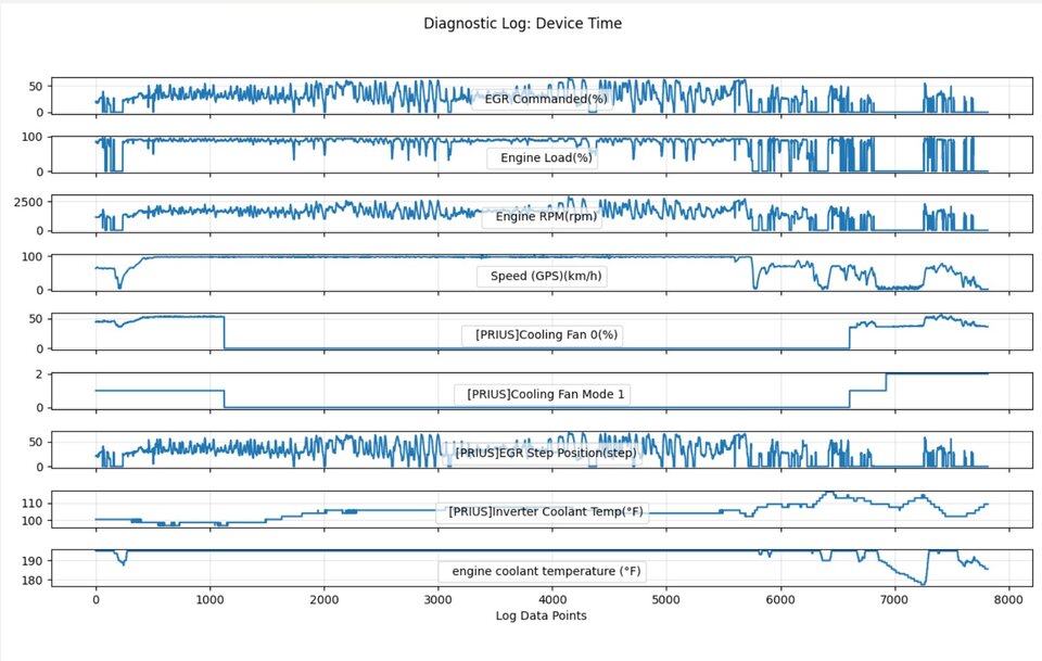

    If you are chasing an overheat issue on a Gen 3, don't just stop at the water pump. Check the Exhaust Flow Control Valve and ensure the EGR system is completely clear. A clogged radiator can also hide its symptoms until you are under high load on a long drive but this valve (Exhaust Flow Control Valve) can "mimic" a water pump failure by dumping massive amounts of heat back into the coolant loop that the pump simply can't keep up with.
    for reference, see log image which i took it from torque pro data and plotted it for your understanding.
    I thought my journey would benefit anyone having similar issue. Any other suggestion for me would be highly appreciated.

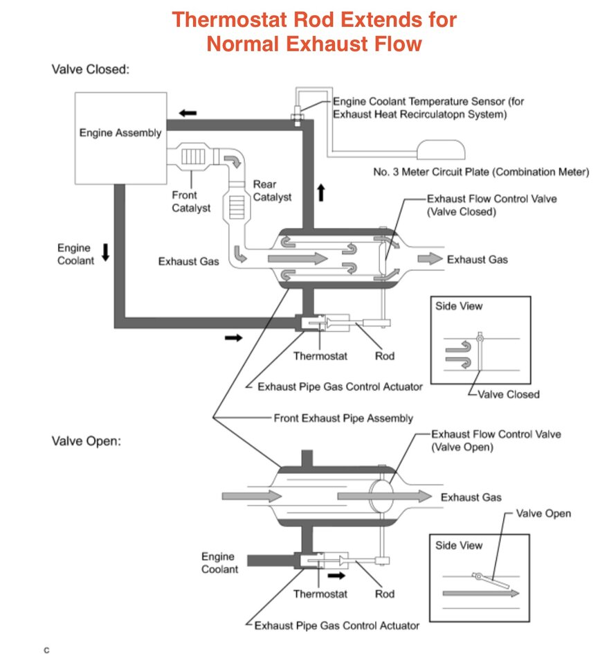

    I assume what you mean here is the exhaust heat exchanger, which is the third 'lump' in the gen 3 exhaust pipe counting from the engine end, coming after both catalytic converters and before the resonator. I assume you chemically cleaned the coolant path through that exchanger. Would that be right?
    I have also heard of chemical treatments for actually cleaning catalytic converters, such as to resolve P0401 codes, but I assume that is not what you did, is it?
    You did a great deal of other work, but happily, your thorough approach did lead you eventually to the cause of the problem.
    I wish I could have made this suggestion before you did all of that work, but anyway: the gen 3 Prius has two coolant temperature sensors, and either one can light the overheat warning. One is in the cylinder head and reads the temperature of coolant exiting the engine, and the other is in a coolant hose near the wiper cowl, and reads the temperature of coolant coming up from the exhaust heat exchanger. Techstream or another suitably-capable scan tool can show you both readings. If the high reading is coming from the EHRS sensor, a stuck exhaust flow valve is a very likely explanation.

  11. ChapmanF
    28,260
    18,713
    Your car is a gen 3, is it not? That drawing isn't the clearest picture of the gen 3 exhaust pipe; this illustration shows more clearly what it looks like.
    (Of course, in a real car, it isn't polished and shiny, and doesn't have a sign reading "Exhaust Heat Recirculation System" stuck on the heat exchanger. ;) There also may be some heat shields around it that were left off for display.)
    In the display picture, you can clearly see the car's two catalytic converters (the first two bulges, counting from the left), and next the exhaust heat exchanger (the third bulge), which is not a catalytic converter, but has coolant pipes attached, and finally the resonator/sub-muffler (the fourth bulge), which is also not a catalytic converter.
    I am not sure what you cleaned "with the help of catalytic cleaner". That is more often something people attempt when there is a trouble code for degradation of the catalytic converter.
    For a coolant overheating issue, I would have my attention foremost on the path followed by the coolant—which does pass through the heat exchanger, but does not involve either catalytic converter.
    Following the coolant path, of course, takes you to the faulty valve that you found, which is not an uncommon failure item, and does lead to the overheating you experienced.
    Using the information in ➡this post⬅ (and the first link within it), you will know as much about it as I do, which isn't everything.

  13. ChapmanF
    28,260
    18,713
    The entire polished part is not the EHRS, it is the front exhaust pipe assembly. It consists of two catalytic converters, followed by the EHRS exchanger, followed by a resonator (or sub-muffler), all welded along a stainless-steel pipe.
    So when Cataclean is poured in the front end, it does flow through the first and second catalytic converters (which it is intended to clean), and also through the EHRS exchanger (which it probably has little effect on) and through the resonator and out the back end of the pipe.
    The usual reason for trying Cataclean would be a P0401 code, indicating that the catalytic converter effectiveness has been reduced by chemical fouling of the catalyst honeycomb. It is not a likely suspect in coolant overheating.
    The thermostatic valve of the EHRS exchanger is indeed a known suspect for coolant overheating, as you found.
    Yes, that's what was happening. The overheat warning on the dash was being triggered by the EHRS temperature sensor reading, while your OBD2 scanner was only showing you the cylinder head temperature reading.

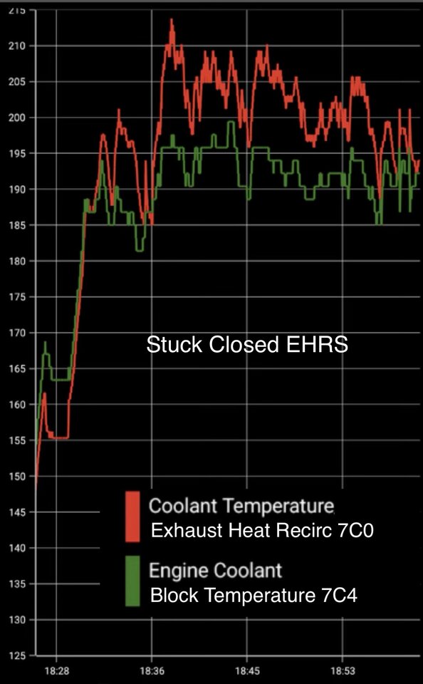

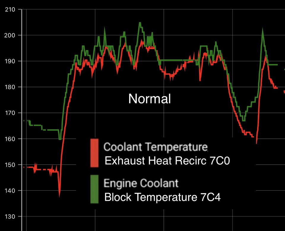

    As Chapman noted, we have been down this road before with a stuck Exhaust Heat Recirc System (EHRS) Valve.
    The "Car Scanner" app can display both temperature sensors without modification and can generate graphs. Techstream has two but they are both called Coolant Temperature, one in the Combination Meter ecu, the other in the Engine ecu.
    Two temperature sensors from Car Scanner app (graph configured from default data scan)
    Car Scanner Graphical Trend with Normal EHRS thermostat followed by stuck closed thermostat. Normal Exhaust Heat 7C0 sensor is almost always lower than Engine_Block 7C4 sensor v red exhaust recirc temp vs green engine temp.jpeg
    The stuck closed graph was on a vehicle experiencing occasional high load temperature warning lights (>248f) while the block temperature remained normal.
    A no cost solution employed by the owner was to force the EHRS open with a small piece of metal shown with pink highlight on end

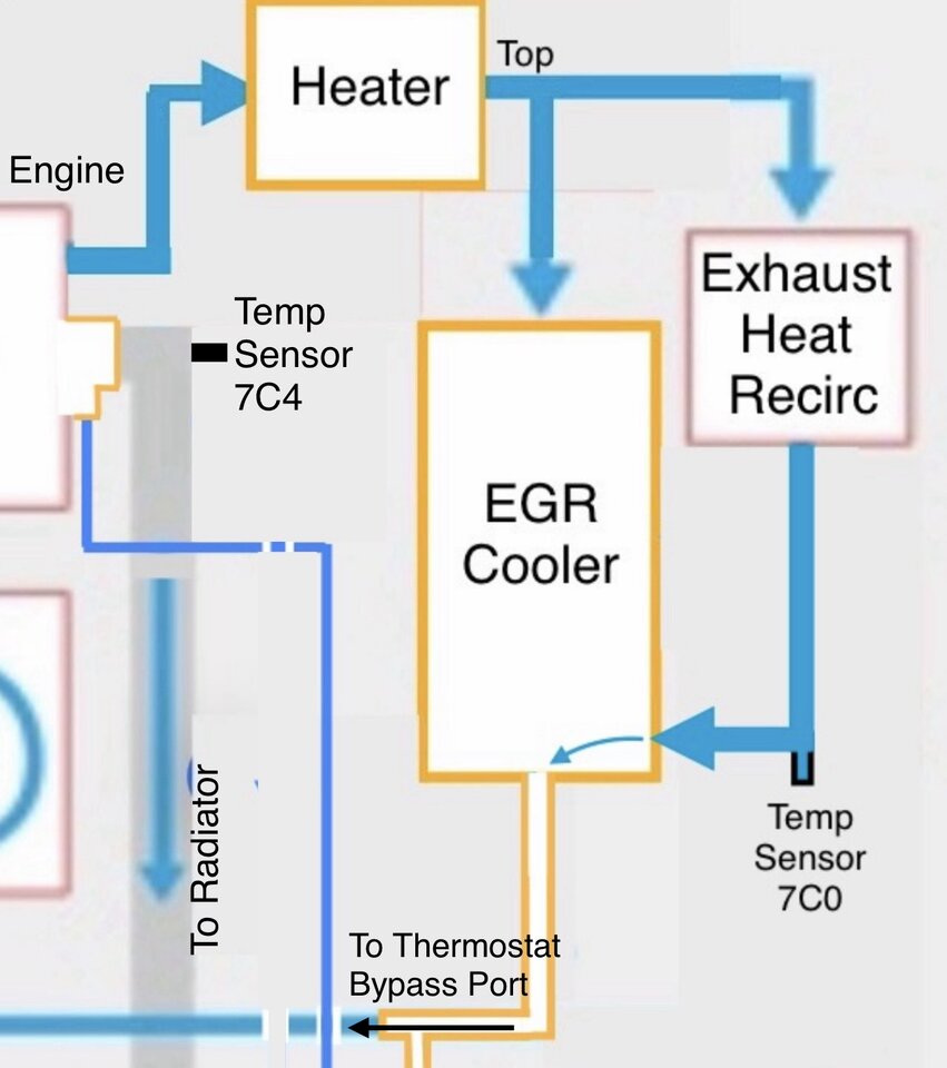

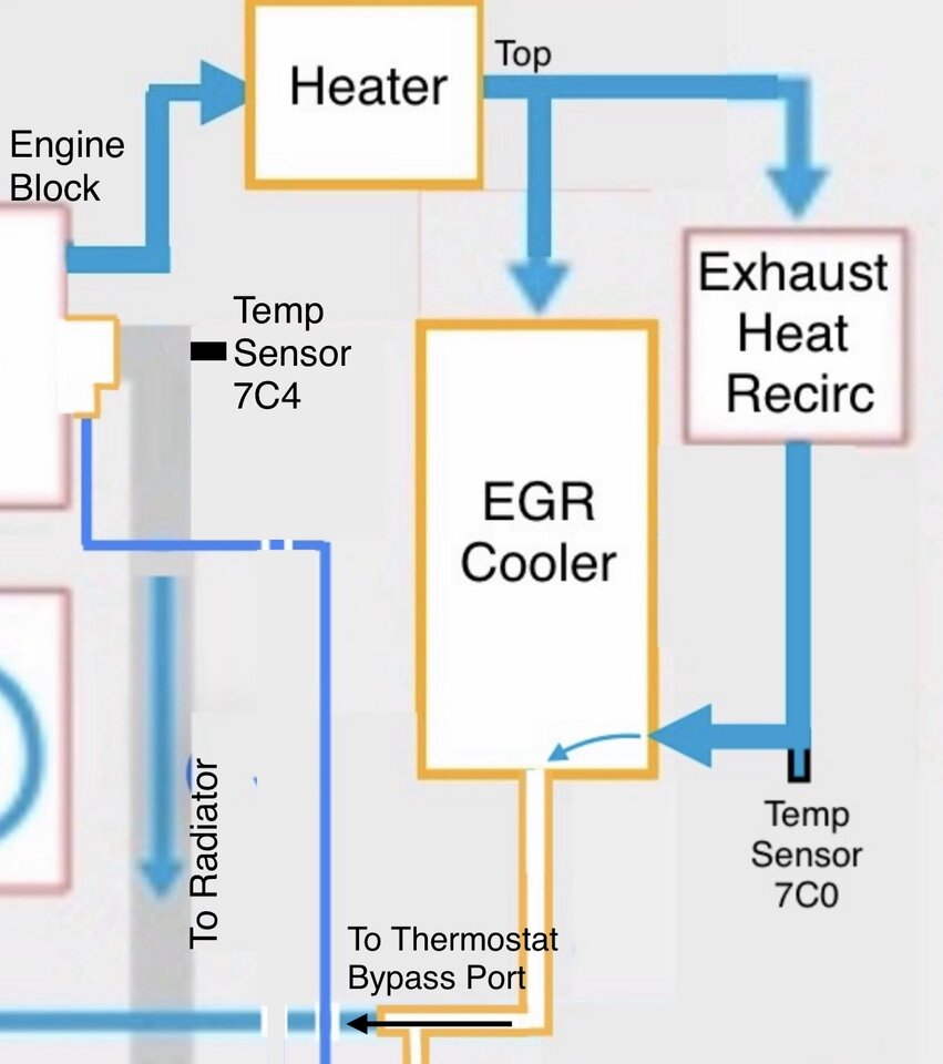

    I have several threads* mentioning the subject including one with the graphs shown above.
    Keys to understanding the situation is there are two separate coolant temp sensors, one of which is immediately downstream of the EHRS system output. The other is on the block coolant output feeding the radiator.
    The stuck valve does not overheat the engine. It is a relatively minor volume feeding into the egr cooler. Even in a normally function EHRS system, coolant flow always continues through it.
    BUT the EHRS system's thermostatic valve moves to allow a straight through exhaust path as illustrated in the smaller attachment above. It does not control coolant flow.
    The major engine to radiator flow is not impacted. Which is why the op mentioned the engine block sensor never overheated.
    Net result of a stuck EHRS valve? Exhaust is forced through more of the heat exchanger warming it up enough to trip the temperature sensor on the dash. On very high load conditions. Without overheating the engine.
