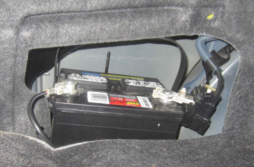

    I went to Wal*Mart a little over a year ago and bought an EverStart 26R-3. It's a good fit and needed no modifications. Cost was a little over $70.

    Nice ...
    part #, price and a pic :)
