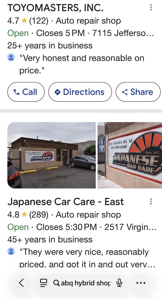

    Your two problems are not mobile mechanic or first time diy tasks. Both have high labor.
    Most legit shops do not want to burn 3 hours of labor just to find a used part is bad. You don't want to pay twice if a used part is bad.
    I would visit these two shops on person (more likely to get advice and pricing in person) and talk to them.
    If they don't do it, ask who might.
