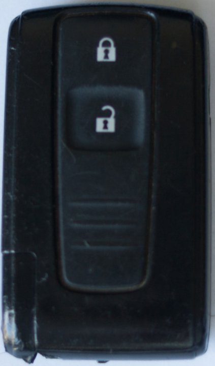

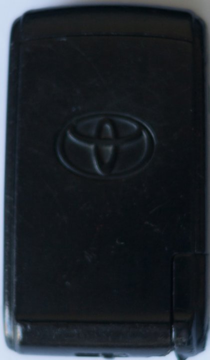

    Basically last night my house got burgled and they took one of the 2 master FOBs. I still have got one FOB with me. You can see the FOB in the picture (non SKS type, black Toyota logo). I now need to deactivate the stolen FOB please.

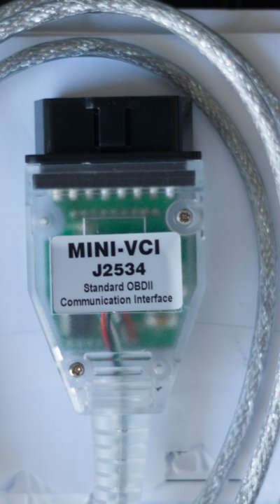

    I have this MINI-VCI cable and a working version of Techstream. I believe it is possible to do but I am not sure how. I have read enough in this forum but I could not find a guide on how to do it. Can one of you please help?

    A bit more info about this Car.. this is a Japanese Import so this is a bit different Gen II from what you see in USA. All the instructions for this car is in Japanese as this is a Japanese Domestic Model. By saying that I would not think it would be that different.

    1. So I got a used FOB from a local car dealer...See the picture. The one with out the keyring is the one I bought. Cost me NZ $90.
