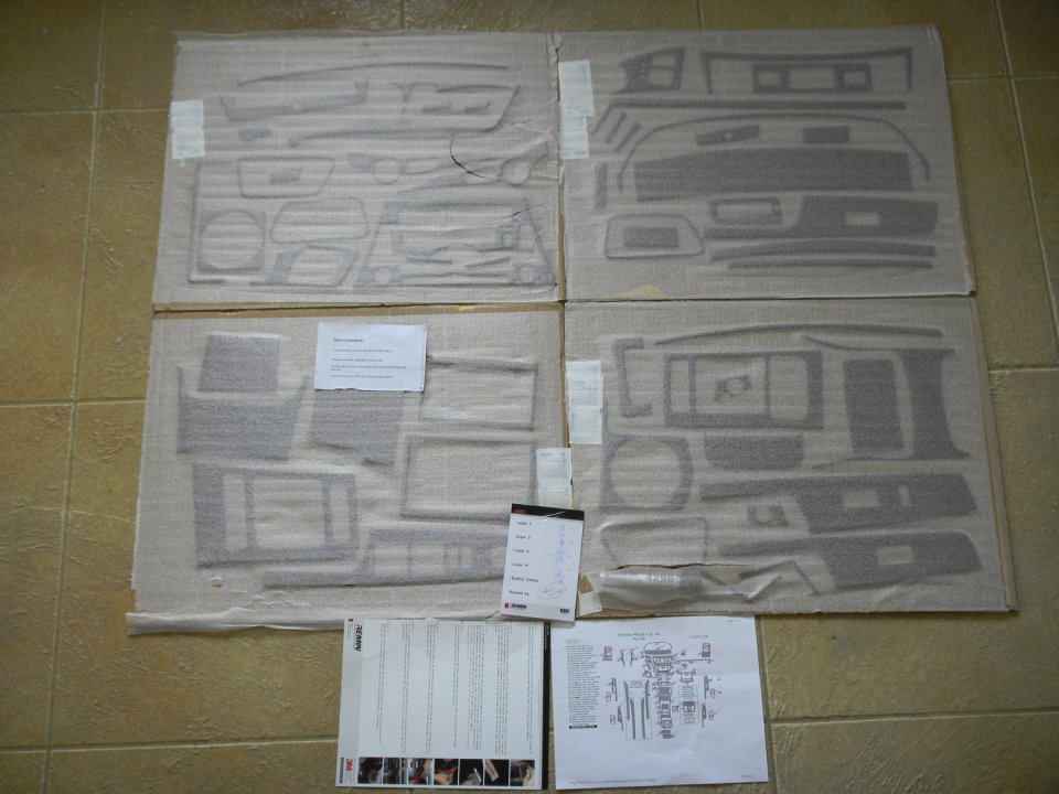

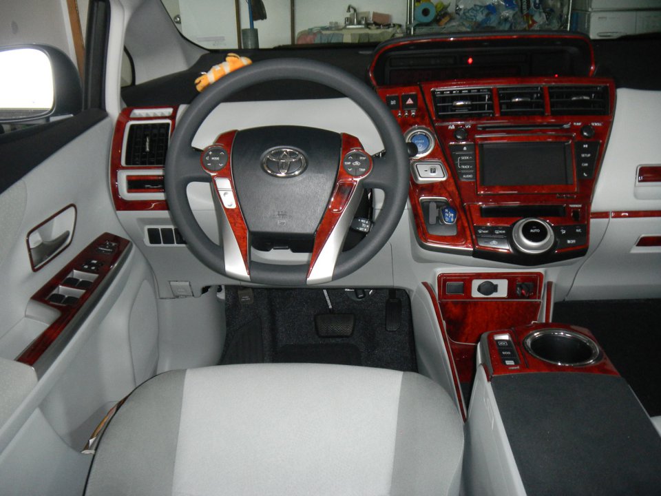

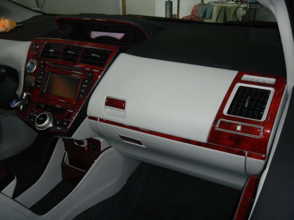

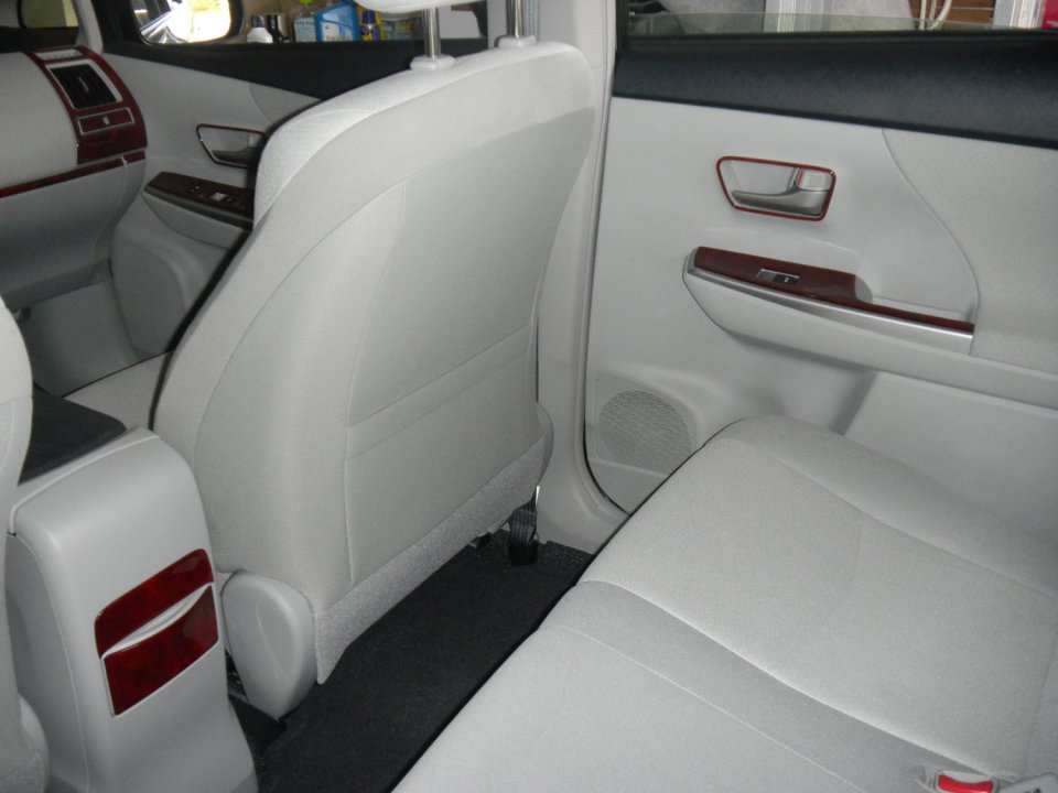

    Got a Remin dash kit from CarID. It is real Japanese Cherry Wood. Total time took about 5hrs. This included checking the parts list, test fitting the pieces, prepping and cleaning the surfaces as well as applying the adhesion promoter and application. Wife loves it and have had nothing but great comments! Local Dealer wants to arrange a photo shoot for display in the showrooms.

    Took about 5hrs total. This is a Remin full dash kit, 57 pcs. I used 54 of pieces. The WOW kit, has less pieces (42pcs.) for the center console . That's why I went with the Remin kit.
    Luckily didn't have that problem. the pieces are pretty thick, about 5mm. Very heavy clear top, thin wood veneer and the 3m foam tape. Test fit each piece a few times and worked slowly and carefully. If you don't press down on the piece, you can lift it up to correct alignment. Only had to do this a few times during the initial placement to line up one corner/edge. Never had to remove a piece completely.

    The steering wheel pieces aren't adhering on the top where it curves over the top. Working with Car ID and will be sending measurements to Remin to have "custom pieces" made. They won't curve over, but should be still look okay. I'll be sending them the measurements and hopefully this should work. I'll post and have pics once this is done. Probably the problem is the real wood veneer. If it were simulated wood, it probably wouldn't be an issue.
