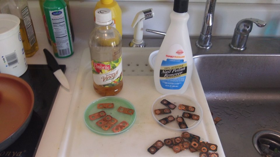

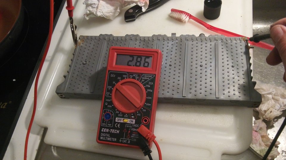

    Hi Vanionbb, I had good luck cleaning the modules in my gen1 last month with acetone. The advantage over water- based cleaners is it dries off immediately and you can switch off between cleaning and checking for voltage leakage with a multimeter without the conductivity of traces of water to interfere. In the pic below, you will see I used clipped an alligator lead on one module terminal and am reading over 2 volts on the case near the other terminal. This was leaking voltage module-to-module.. You really have to wipe the lead all over the whole unit casing, then swap terminals and leads and do it again...you can probably do the whole bank in a couple hours.
    I was lucky and didn't need to replace any modules, I had voltage leaks between modules and broken sensing connectors.
    Bought my car dead and down last month like you did, now happily pulse and gliding. I found good advice here on Priuschat.
    I charted voltage leakage between adjacent modules and module to battery rack before taking it apart and used that chart during reassembly, module by module, to ensure that I got it the first time and I did have to reclean 2 or 3, but avoided complete re-teardown.
    I used and liked the Halogen headlamp trick to check modules for voltage drop under load. The no-load voltage means little. You can find it in postings here. I charted voltage befor load, during, and recovery after one minute.

    If your terminal sealant is gooped onto the bus bars, acetone and vinegar will clean them with minimal labor.

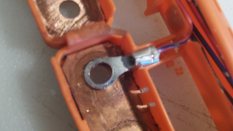

    If you find broken sensor wire connectors, no need for a $100. harness, fixed mine for $2.94

    There are a number of things that will clean the copper buss bars. If you want a really cheap/effortless cleansing, mix 4 packets of Kool Aid (lemonade flavor) into one quart of water and let it sit for 8-12 hours, wire brush any stubborn stains/deposits and let it sit for another 8 hours. I cleaned tons of salt water corroded brass and copper this way while serving in the Navy. I works awesome and its cheap. :)
