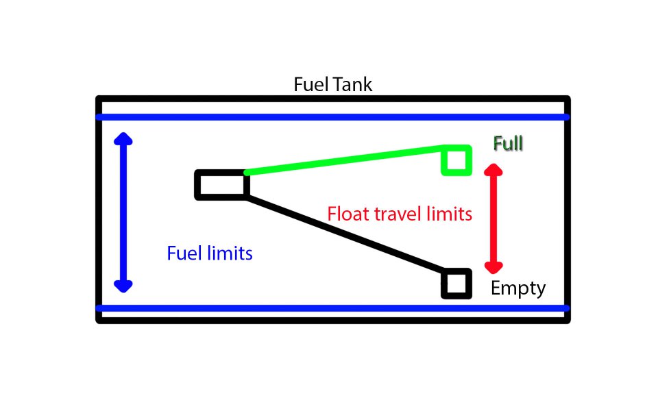

    You'll always get more mileage from the top of the tank. After the fuel gauge float stops on it's limiter, you continue to pump fuel until the tank is full. You get added, unregistered fuel after the float reaches it's limit of travel in the tank.
    Here's a simple diagram I made. I hope it helps to understand how it works.

    Isn't fuel consumption determined by injector delivery and not tank level?

    Don't take it literally that each gas gauge bar is equal to one gallon...or even the same quantity each. It is still an analog gas gauge being approximated on a display with 10 bars.

    1. The gas gauge, like all analog gas gauges, just gives you a hint about how much gas is actually in there. On the Prius, "Full" means that you've got a gallon or two before you come off of full. 1/10 and Blinking means you've got ~1.5 gallons left (i.e, 30-50 miles, depending.)
    2. The MPG numbers and such are calculated by the engine computer. The computer jiggers up how much gas it thinks is going into the engine, divides by the miles, and gives you a report back on your MPG that's (usually) 3% or so too optimistic. There's a lot of variation in the readings, apparently, car to car, so Accuracy Is Not Us.
    3. The DTE (distance to empty) on the dash is supposedly the current MPG times the number of gallons in the tank. It's known to be wildly optimistic about how far you can go when the tank is full and wildly pessimistic when the tank is near empty. (I've seen it report -10 miles to empty when there's still a gallon in there.)
