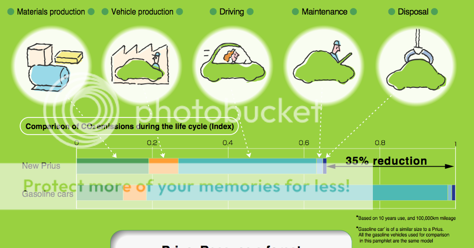

    This clipping is from a Toyota Publication titled "Prius Green Report"
    The small print in the bottom right corner says that the comparison car is about Prius size, and calcs based on 100,000 Km (about 60k miles).
    Staying with one unit defined as 60k miles in a conventional car getting about 27 mpg including manufacturing and disposal, and assuming 60k miles is about 1/3 of a Prius' life, we get
    Prius for 60k miles: .1 unit (manufacturing + disposal + maintanence) + .4 units (fuel) = .5 units
    SUV for 60k miles: .8 units (petrol only)
    If you want to convert the ruler to absolute numbers, I think you can, based on 55 mpg for the Prius, and ~ 19.5 lbs of CO2/gallon of gasoline. This works out to ~ 5600 pounds of CO2 per 0.1 unit = 60kmiles / 55 mpg * 19.5 lbs/gallon / .38 units/60k miles /10
    The CO2 breakeven point in kProspero's comparison of a 17 mpg SUV vs say a 51 mpg Prius is about 7000 miles (19.5 * .04 pounds of CO2 saved each mile).
    This is only CO2. Arguments surrounding landfill and toxic metals etc are mute so long as your SUV stays in your garage; and as others have pointed out, delaying the SUV's trip to the grave is the best thing you can do here.
