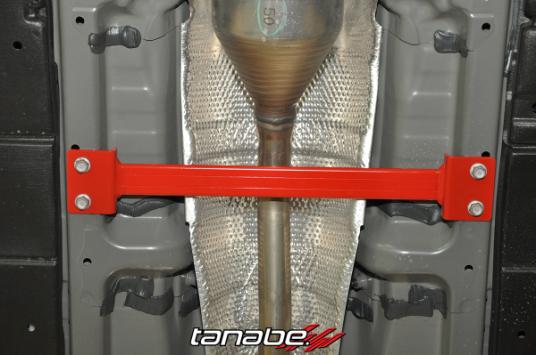

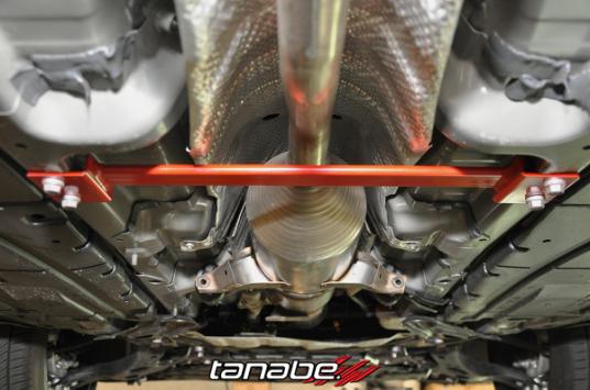

    Interesting! Thank you very much for posting this valuable information.
    This might not be what you want to hear, but this is my honest assessment,
    They added an extra attachment to the "hourglass" brace. I wonder if it works with the newer OEM "tubular" brace.
    It, again, appears to be made from the Tanabe "thin walled" aluminum tubing an welded to thin "bent" aluminum plates.
    I prefer "extruded" thick wall aluminum tubing formed in one piece, annealed and age hardened to the T6 temper, not de tempered and weakened by welds.
    The Tanabe must add at least another pound or more, while mine weighs an ounce less than the standard "hourglass" brace.
    I was an early adopter of the TUB153F front under brace on my "v," until I examined it and found the same issues stated above, including the fact that the brace "hung down" and additional 7/8 inch and further deduced ground clearance. I actually had two users of the Tanabe contact me to replace their Tanabe braces with my model. They had lowered cars that scraped on bumps on the road. One actually broke the Tanabe bar. After replacement, they have reported NO issues.
    Sure, I'm know, as I did, many will buy on the basis of the Tanabe "brand name" and that it is Made in Japan.
    More photos.....
    It's similar to the JDM brace.

    Ok Rude person's. We get it. You can engineer and make what you consider a better product. After repeated posts by you on multiple forums touting your product and bashing Tanabe, it gets pretty tiresome. I originally respected your engineering skills but that has really begun to wane over time. So this may not be what "you" want to hear but hey, its "my" honest assessment. I will parapharse what Tywin Lannister stated on one of my favorite shows "Game of Thrones", "If you have to keep telling people you are the King, then you're really not".

    Mac Prius,
    I "liked" your comment. I respect you opinion. You are entitled, however, to ignore mine, if that is your desire. Unlike you, I am not offended or tired by your comments.
    Some people just can't stand honest comments. I just wish these companies did not have the"It didn't come from here, attitude."
    I have NOT applied for any patent protection for any of my designs. Anyone is free to use and copy them.
    I adopted the original Tanabe HUB153F design and gratefully recognize their innovation. I just wish that I did not have to redesign the Tanabe TUB153F front under brace. I still have the original one I purchased more than a year, ago. I just wish they would redesign it to allow less "hang down" and better road clearance. Also, the extra 3/8 inch of "hand down" of the tubular spools below the crossbar can be eliminated to reduce decreased clearance. The many users of my brace has informed that there is less than plus 1.5 mm or variance between a faeror7y new Prius and a three year old one with over 100K miles. Yet, they have designed theirs with 4mm of "wiggle room."
    Here is YOUR opportunity to provide Tanabe with the way and means to improve their products for the benefit of ALL.
    This would be a problem, if Tanabe is looking for "YES men."
