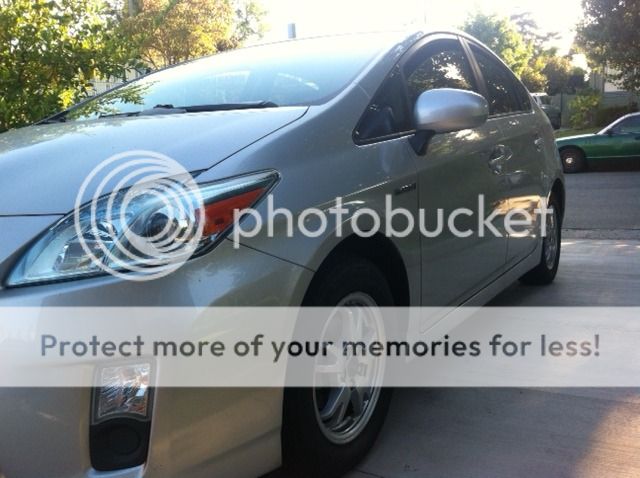

    The new to me Prius is a 2010 Package III with 111,400 miles on it. It's been a California desert car (Hemet) and I'm the second owner. The history seems pretty good on the Toyota site and it has a clean carfax. Seems to have had it's first oil changes at Toyota and evidence of subsequent changes at a nondealer oil change place after that (valvoline window sticker). Toyota had also replaced a few headlight bulbs and a malfunctioning nav unit.
    Through some vendors mentioned in the forum I ordered a new under engine cover and intermediate piece to bumper cover, the proper coolant, engine and transaxle oil, spark plugs, filters, spare oil canister, an air lift tool and went to work:
    Changed the transaxle oil. Used a gear oil hand pump to fill it.
    Changed the ICE coolant. Filled using the AirLift tool.
    Changed the inverter coolant. Filled using the AirLift tool.
    Changed the oil earlier than indicated on the window sticker to get on a 10k schedule.
    Took oil sample to send to BlackStone Labs.
    Took a good chunk of the car apart and changed spark plugs. Condition looked good.
    Removed plastic covers from rims. (Still have no idea why Toyota puts these on top of aluminum rims.)
    Put on TRD center caps.
    Tires to 40PSI.
    Reset all trip and consumption records.
    Used Pela extractor to pull all fluid from brake reservoir then replenished. (Since bleeding is an involved and more than likely a dealer only exercise I went with replacing as much as was accessible without introducing air to the system.) My thinking is that since brake fluid is hydroscopic, a bulk of new 'dry' fluid will pull any moisture it can from the remaining fluid it comes into contact with.
