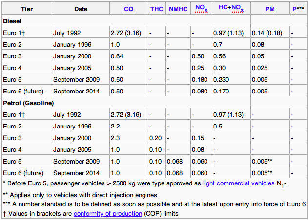

    If by overseas you mean Europe, their emission limits are more lax than the US, in no small part to accommodate diesels. The EU continues to have one set of standards for diesel and another for petrol (from wikipedia):
    So it is not a case of better diesels or higher quality fuel, it is simply lower standards. Euro6, slated to start late 2014, is reigning in diesel emissions although if I am reading the table correctly the regs are set up to let diesels trade Nox for HC or vice versa.
    For giggles, compare the *future* Euro6 diesel limits to the Prius G3 from 2010:
    CO 0.258
    CO2 emissions 89 g/km
    HC 0.058
    Noise level 69 dB(A)
    NOx 0.006
