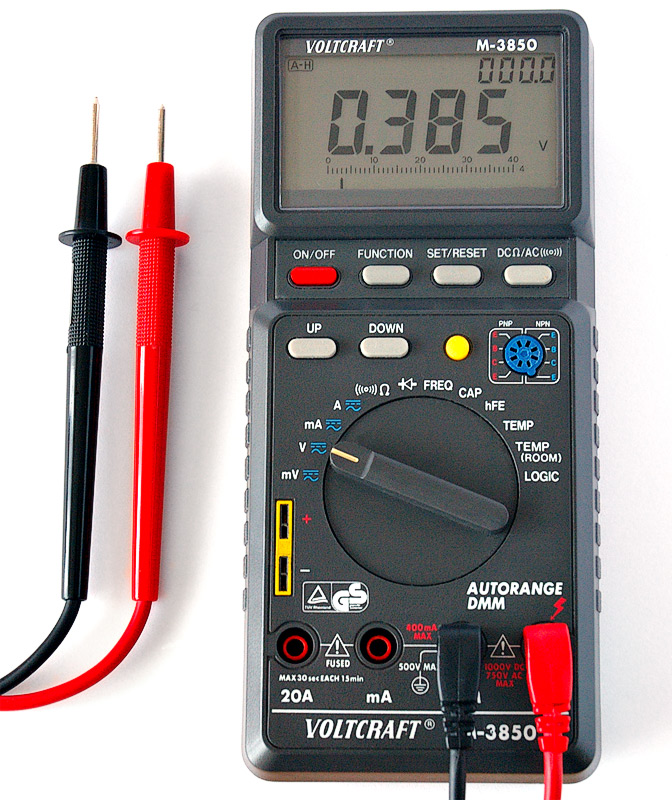

    Just check the plug voltage with a multimeter.

    After you test the voltage of the outlet with a multimeter, you can then test if the outlet is wired correctly with one of these. When all the testing is done, then you can ask for permission. This is what I did to use the outlet at work.

    When I was rewiring my house many years ago, I found that you can easily check outlets for ground and polarity with a simple test light. Just place one pin of the tester (grasping the insulated handle areas) in the smaller slot (this should be the "Hot" one) and the other on the outlet cover screw. If the light lights up, you have a ground and the polarity is right. If it doesn't, first put the light prongs in both slots: if it lights, try using the large slot and the cover screw. If that works, you have reversed polarity and the outlet was wired backwards. If neither slot plus the center screw or box gives you a light, you have no ground in that outlet. If the outlet isn't grounded but you can get a light by touching the Hot slot and the metal outlet *box* only, then the outlet isn't grounded, but *can be*, just by adding a grounding wire to the box.
