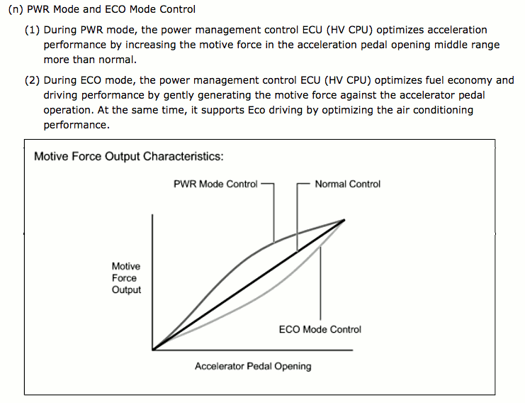

    The difference between the ECO and the POWER modes have to do with pedal sensitivity. In ECO mode, the effort of the engine relative to the pressure on the pedal is lower than it is in POWER mode. As you discovered, this effect is only in affect for the first 50% of pedal travel. That is, if you push the pedal more than 50% down, the Prius will assume you are doing so because you need the power NOW!
    Here's a chart often used to show the power curves of the two modes.
    This chart comes from Hobbit's website: Hobbit's techie-rants
    If you are looking for more information than any human should ever know or just having a hard time making your eyes go blurry, spend some time at Hobbit's site. It's chocked full of information.
