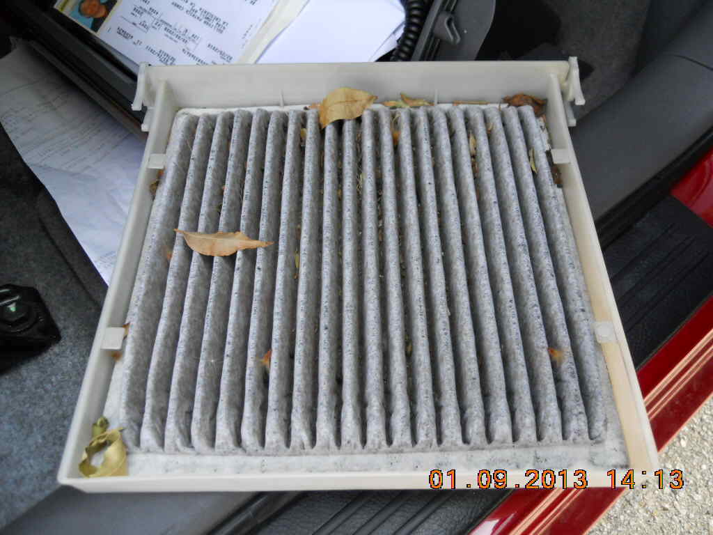

    As you can see the intake air vent can get really clogged with leaves and stuff!
    It ends up here, in you cabin tour filter..
    Make sure the system is cleared of any debris that will impede the air flow!

    Did that last night as well, there were some leaves and such, but cleared that out as well. This morning my entire window was iced up, and had to use the windshield fluid to cut through the ice, also there was noticeable fogging inside with the air turned to windshield only I could still feel the air coming out at the feet well and also bi-level.
