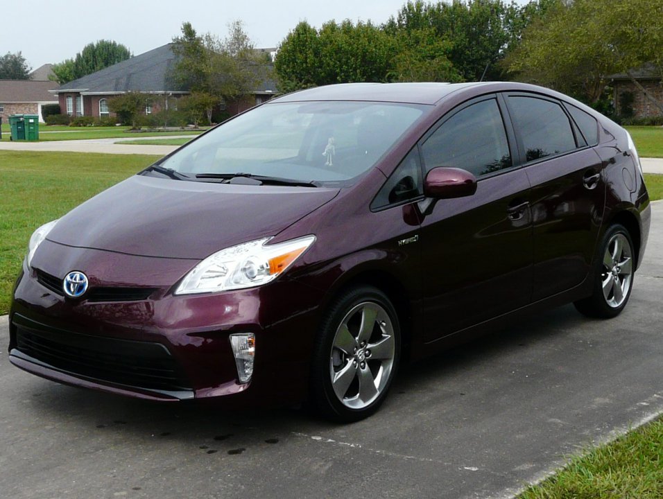

    So bought our first Prius in 2006 and just bought a new Persona. Getting good mileage and happy with everything except the ride. It could be the 17" wheels and tires. I think the ride is worse than my 2006.
    Just wondering how others feel and also looking for any solutions.
    Thanks

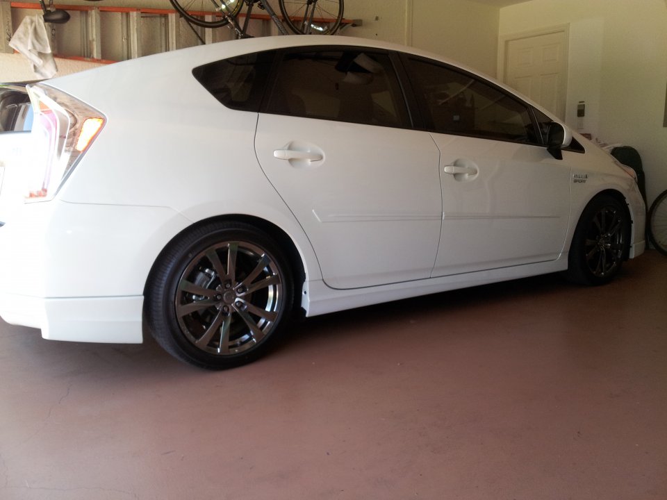

    I wasn't thrilled with the ride, either. But, after installing the TRD Springs and Anti-sway-bar, I couldn't be happier!
    Daddyjeph and WE0H like this.

    Bottom line, if you like a sporty and firm ride, the 17's with TRD Springs and Anti-swaybar are the way to go. If you enjoy a softer ride, the 15's are the only way to go. I prefer a stiffer ride with less sway and more control like you would find in a 328ci. With that said, an unmodified suspension with 17's is not going to make you happy.
    Unlike the standard 17's, I have the TRD Forged Rims. They improve the ride substantially over stock 17's. Here is a quote from wisegeek.com which can explain it better then I can:
    Forged wheels are strong, dense, yet very light wheel that high performance car enthusiasts use for their cars almost exclusively. The term “forged” refers to making an alloy wheel by forcing a raw block of metal into a shape with extreme pressure. Forging is an expensive, multi-stepped process.
    Most of the alloy wheels on the market are one-piece cast wheels, not forged wheels. The difference between the two processes is that casting involves placing liquefied aluminum into a mold. As the aluminum cools, it is formed into a wheel. There are several different ways to accomplish this, including gravity casting and low-pressure casting.
    The main benefit of forged wheels over cast wheels is the weight. To understand the benefits of lighter wheels, it is necessary to understand the differences between “sprung weight” and “unsprung weight” in relation to your vehicle. Sprung weight is supported by the suspension, including the transmission, engine and chassis. On the other hand, unsprung weight refers to everything else, including the suspension system and the components attached to it. Surface imperfections in the roads place force on unsprung weight, which then reacts with its own movement. The less unsprung weight in a vehicle, the less it is affected by the road and other outside forces.
    Daddyjeph likes this.
