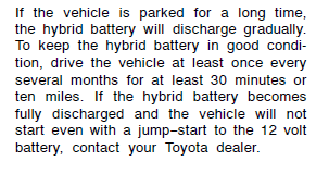

    Absolutely no need to disconnect the hybrid battery service plug, for 30 days. For a longer hiatus, say over 3 months, even then disconnecting that service plug doesn't really help much I think: it'll isolate it, but don't think it prevents it running down. Toyota stresses that for the health of the hybrid battery the car should driven at least every few months.
    From your gen 2 Owner's Manual, somewhat vague:
    And from gen 3 Owner's Manual, slightly less vague:
    Both quotes use the phrase "several months". Who knows, three? Four?
