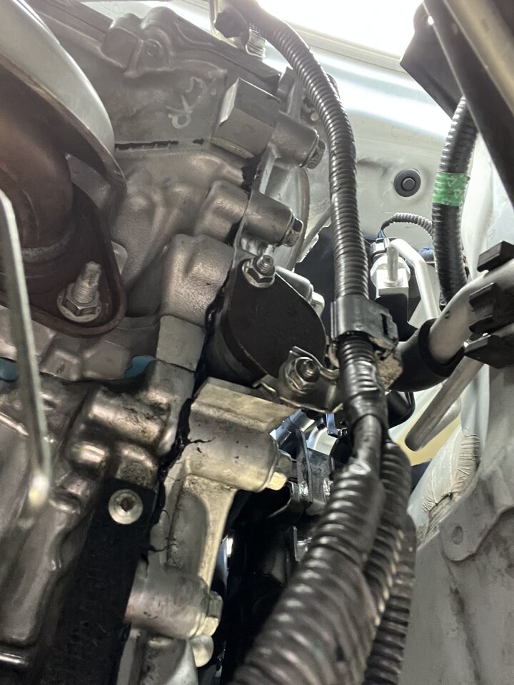

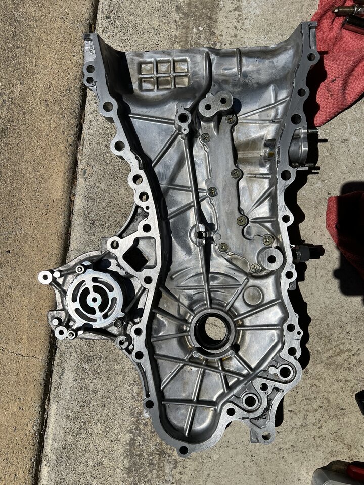

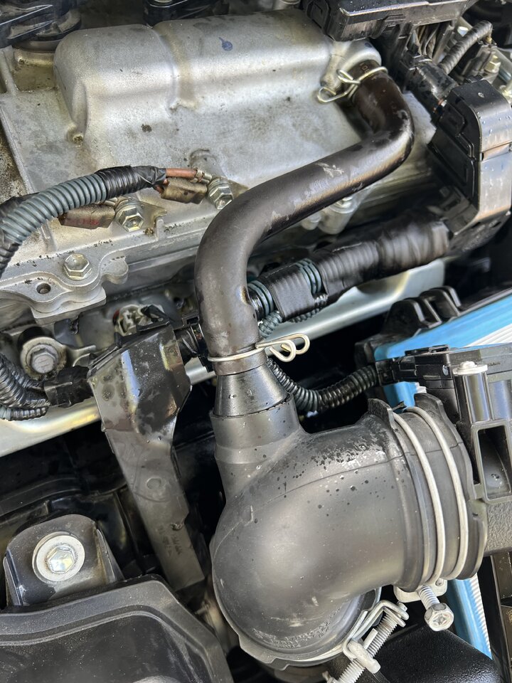

    Just finished resealing my timing cover leak. Going to recheck in 10k miles to see if it’s still leaking or not.

    Toyota’s FIPG. It’s the white tube. This time I let it cure for 24 hrs before I put in the oil and I added more fipg at the leak spot lol.

    I think I didn’t put enough fipg at that area. Everywhere else was fine besides that spot by the timing chain tensioner for some reason. I’m gonna recheck in 10k miles and see if it’s still seeping out from there. Overall my car isn’t burning oil, it was just seeping from that spot. So losing 1 1/4 quart of oil is pretty good within 10k miles with a seepage.

    yeah but that’s the thing, it wasn’t that area… it was right below the timing chain tensioner where the 14mm #2 bolt was at on the timing cover. I added an extra dab around the bolt hole and underneath it as well since it was leaking from there.

    Toyota recommends a horizontal bead of sealant at each of the engine seams. My take: apply the regular bead to the timing chain cover, and apply those horizontal beads directly on the seams, on the engine face.
    They also show a thickening of the regular bead, at certain points, and while they don’t clarify, it looks to be at those seams. Just saying to thicken the reg beads at the horizontal engine seams would be simpler, compared to the dimension laden drawings they provide. (See attached)
    Gasket Masters was using and advocating Permatex Ultra Black. Compared to what Toyota specs in Repair Manual, it has a much longer cure time, maybe better for DIY.

    Maybe some dirt got in there when you put the cover on, or maybe when installing it you
    accidentally removed some of the sealer. It's easy to do. I was worried about it when I installed
    the cover. Not much room to do it.
    Main thing is you found it and fixed it.

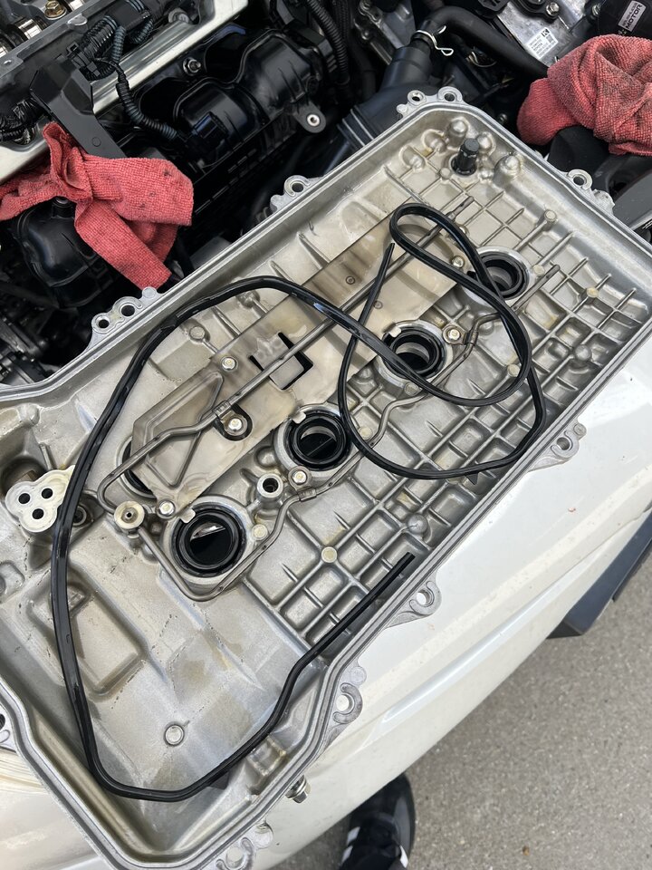

    If you have louder than normal engine noise after doing a timing cover reseal, make sure you didn’t squish your valve cover gasket and having oil leaking out In the front by the intake manifold.
    Ask me how I know? :ROFLMAO::ROFLMAO:
    all fixed an no more louder than normal engine noise. (y)

    :ROFLMAO: Yeah I had loud engine noise and lack of power as if it was the time my inverter IPM failed on me.
    Glad this was a minor set back, I thought it was going to be too much fipg applied on the timing cover and some how the fipg got dislodged into the oil passages, that would’ve been bad.
    Overall this took me 1 hr to fix. Didn’t have to remove a lot to remove the valve cover. (y)
