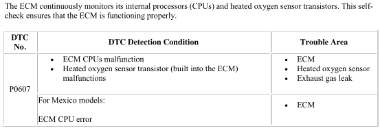

    That power to the heater is controlled by a power transistor inside the ECM. There used to be a list of "Murphy's Law Corollaries" that got passed around in techie shops, and one of them was "a transistor that is protected by a fast-blowing fuse will protect the fuse by blowing first".
    Doesn't always happen, but if it does, I think there's a trouble code for it. If the transistor is kaput, the ECM is needed.
    Found this in a gen 3 repair manual, but haven't checked if it's the same in gen 2:
