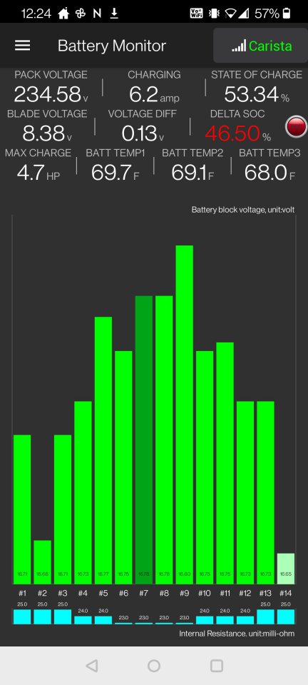

    If you scanned it with Dr Prius, what did the battery cell voltages and internal resistances look like?

    Yeah just do the basic test, the one that doesn't require driving, or the other requiring you to idle with AC and various loads. The display will look like this:
    (Just scooped off the internet, as an example)
