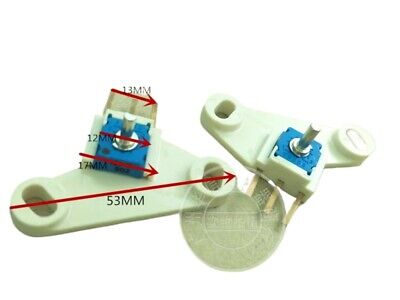

    There is nothing to break in a three-way valve for a thermos system. The cause of all the troubles is the wear of the tracks in the potentiometer, which transmits its data to the ECM when the valve is turned to a certain angle.
    RVQ121 12V 502 5K Ceramic potentiometer strip PPS-GF40 360 rpm
    If you can find such a potentiometer and replace it, your three-way valve will last longer than the car.
    The potentiometer costs about $7-$8

    I totally see where you are going with that. Looks like a basic trimpot of sorts. Heck I could probably spray some old skool tuner cleaner into it, move it back and forth a bit and get it to work again. But I'd have to remove it from the car and get access to the pot.
    How confident are you that the photo you attached (that I can only see when I quoted your message) is the exact part needed? Have you actually had your eyes on one? Got any photos of the inside of the three way valve assembly?

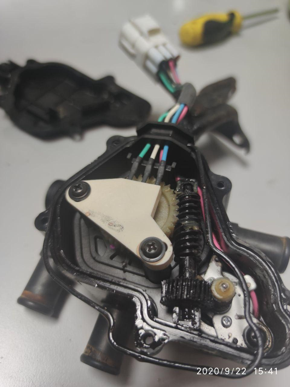

    Of course, the three-way valve must be removed to gain access to the potentiometer.
    The potentiometer is located under a cover that is secured with 5 screws.
    View of the potentiometer with the cover removed.

    Oh, that's a great photo. I'll give replacing the pot serious consideration. My only worry is how to calibrate the position of the pot when it gets installed, but that could probably get worked out.

    Well now that you put that picture up so the potentiometer is the white part with the two black screws? Iusuakky put stopper in mid position and remove blk spiral gear . So the thing can rotate nothing . At the time I wasn't worried at the light was on as long as I had heat.
  12. ChapmanF
    28,689
    18,993
    The potentiometer is the blue part with the silver rotating shaft.
    The white part with the two black screws is the bracket to hold the potentiometer in place.
    When it's in place (like the picture just above), you don't see the potentiometer, which is underneath. Look at the pics a couple posts further up.
