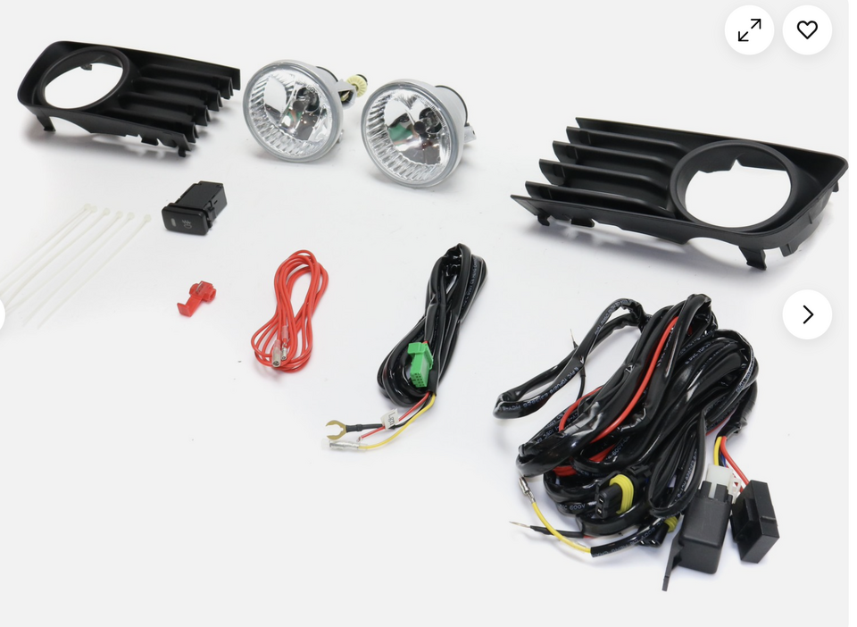

    I recently purchased a set of aftermarket fog lights from Amazon for my gen 2 (see photo of kit below) and read and saw how most everyone is complaining about the aftermarket switches they come with in regards to fitment in the spare slot. So i ran into a gen 2 with the OEM fog light switch which is in the wiper switch assembly so my question is, is there a way to wire up the OEM switch to aftermarket fogs that use that square switch to the OEM switch or would I need to run the specific harness off the OEM fogs for this?
    Anyone do this that can run by me a HOW TO or any ideas if it's even possible. I am not that inclined to read wiring diagrams lol as I get lost most of the time with them but more hands on if that makes sense.
    Thanks

    Anyone with this knowledge? I cant believe no one has attempted this here LMAO

    I've done it on a gen 3, using a Toyota stalk with the fog switch, and the relay and circuit they already built into the fusebox. But it's highly likely the details for gen 2 aren't all the same, so unless someone does come around with your exact answer, reading the diagram might be the fast way.
    Toyota Service Information and Where To Find It | PriusChat

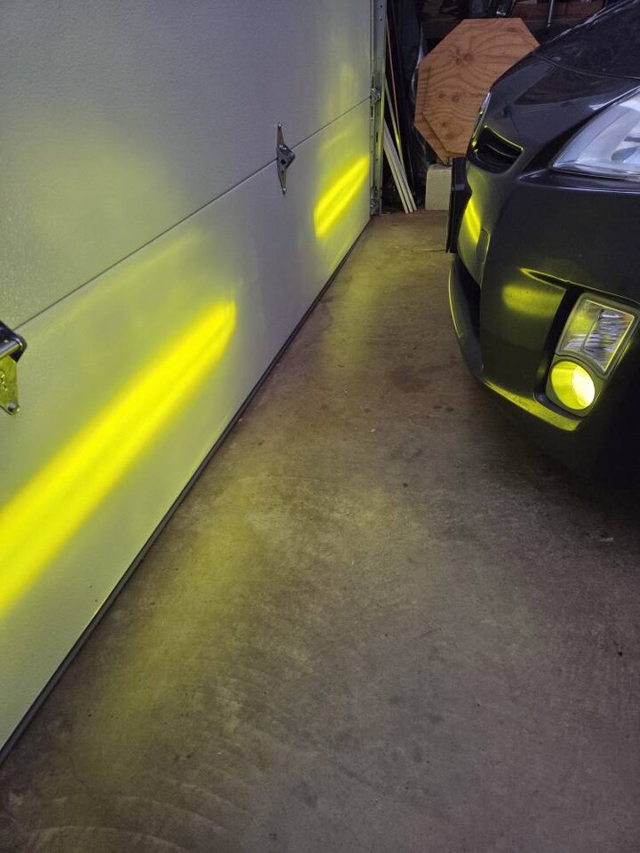

    I used the Toyota switch and wiring and grille openings, but Morimoto LED foglights. They're nice.
    Also, being LEDs, allowed me to put just a 3-amp fuse into the pre-existing FOG slot in the fusebox, instead of a 10-amp or whatever the original was supposed to be.
