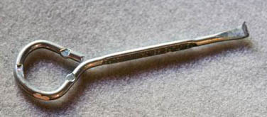

    Regarding those plastic fasteners:
    I mostly use a paint can opener tool to lift their caps, release them. Occasionally a slim blade screw driver as well. Before reinstalling them I rinse them in hot soapy water, try to get the grit out. This keeps the internal mechanism clear, less likely to seize, causing them to break on removal.
    Here's an image of paint can opener. A little hard to see, but it's got a 90 deg tang at the end, good for levering up the fastener head and assisting in pulling them out:
