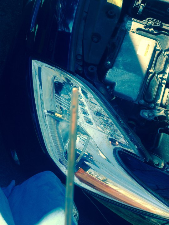

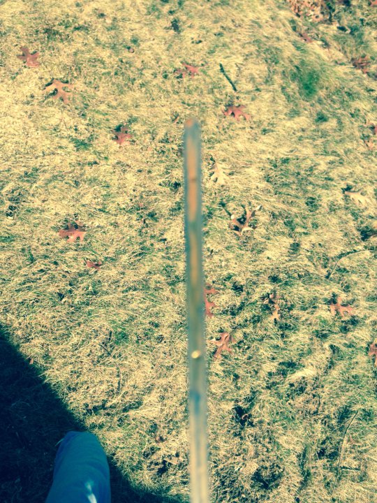

    I recently took my car in to the dealership for a 50,000 mile oil change. 2 days later I checked my dipstick and the end showed a very discolored oil (rust colored) which had a lot of sediment in it.
    I have since taken it back to the dealership and they don't seem to know what the problem is. They have since changed the oil again and it still has a rust color to it.
    Has anyone experienced this before?

  8. frodoz737
    frodoz737 Top Wrench
    Aug 26, 2010
    4,530
    2,437
    HD pictures please.
  9. briansgreencar
    briansgreencar Junior Member
    Dec 26, 2009
    Delmar, NY
    Not the best quality-but it shows the rust color Mixing with fresh oil

  15. frodoz737
    Aug 26, 2010
    4,530
    2,437
    Know it's not my place to tell you what to do, but do it now. Anything "not oil" here is very bad.

  18. Easy Rider 2
    Easy Rider 2 Senior Member
    Aug 5, 2014
    1,584
    258
    Ocala, FL
    2013 Prius c
    There are several things that the "mechanics" can do.....like pressure test the cooling system and look for oil floating on the top of the coolant.
    That sure looks like water is getting into the crankcase.
    This time of year, that can also be caused by a fault in the Positive Crankcase Ventilation (PVC) system, allowing water to condense out of the air when the engine is first started cold.
    Do you use your car for a lot of short trips when the engine cools down between them ?
    In rare cases, that can be "normal" and indicates a need for a longer engine run once a week or so.

  20. frodoz737
    Aug 26, 2010
    4,530
    2,437
    While the photos and description do "appear" to be a water based substance, take it back and let the "mechanics" do their job to find out what it is for sure. Having the same results after another "oil-flush" would indicate the problem is real. When a Service Adviser or the runner up for Service Manager says I don't know...that usually means nothing except they want you to pay for their time. Escalate the process before more "possible harm" might be done to your engine.
