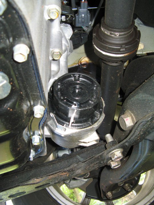

    If you want inexpensive (cheap), this one fits well;
    If you want a lifetime wrench, this is the Toyota world standard;
    Toyota Lexus Chrome Oil Filter Wrench Tool 09228 06500 02 | eBay
    If the filter housing was installed at the factory and NEVER removed, do as I did, and mark the position with a white paint marker, so you'd NEVER need a torque wrench to retighten it to the proper torque.

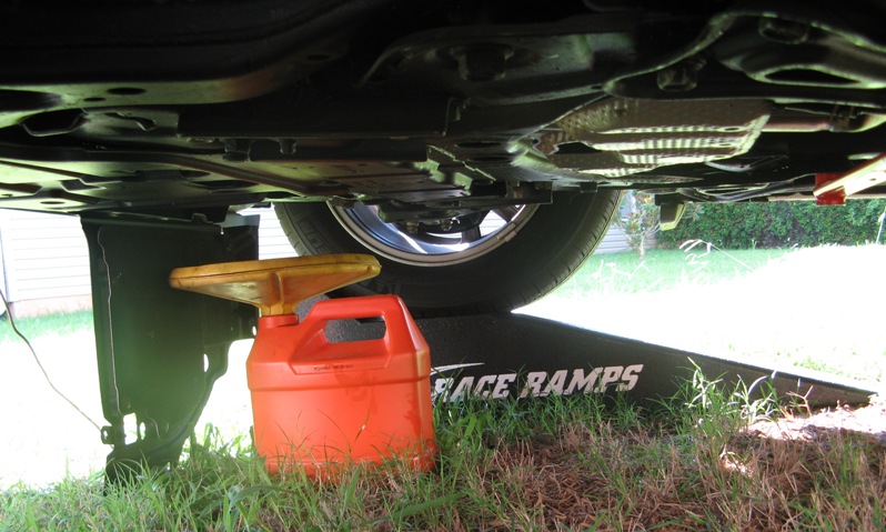

    My favorite is this funnel from the Wedco branded oil drain kit. The wide funnel screws onto a standard anti-freeze or windshield washer fluid bottle. I used an old Go-Jo hand cleaner bottle, which is lower profile.
