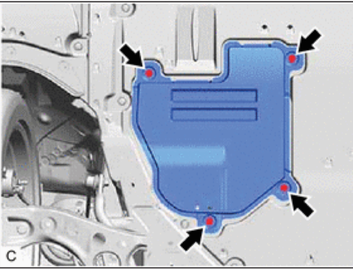

    The 2023 is pretty straightforward. I assume the only panel missing is the small one that covers the oil drain and filter. I also assume there's no damage to the main under cover. If so, these are the parts you would need. The clips listed are what the screws thread into. If your car still has them, you wouldn't need to replace them unless they're stripped out. But they're cheap enough you might want to replace them anyway just in case. Your call.
    51447-47040 - Cover, Engine Under, No.4 Center
    90159-60477 - Screw, W/Washer Tapping x4 (if missing)
    90467-05176 - Clip x4 (if missing)
    If you pick your dealership carefully and wait until Labor Day for the 20% off sale, you could get the whole thing for $42; $34 for the cover and $8 for all the screws and clips. Though you'd have to add a few more things to qualify for free shipping. Maybe a set or two of wiper inserts, or some oil and filters. It would be a good time to stock up. Look for a dealer with 31% off MSRP.
