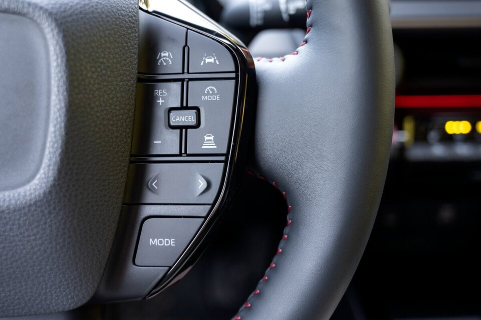

    I believe the top right outer steering wheel button toggles that function ON-OFF.

    No. That button is for Lane Tracing Assist. What the OP is describing is Lane Keeping Alert. That can only be disabled in the settings menu. And it might turn itself back on every time you start the car. Not sure.

    If we're talking about LKA; it looks like the inner button may toggle that function. I'm making inferences based on the iconography; so double check with your OM.o_O:rolleyes::whistle:

    No, I'm very certain the button is for LTA, not LKA. Personal experience plus the manual.
    Remember: Tracing(LTA) gently keeps you in the center of the lane while in DRCC. Keeping(LKA) not-so-gently keeps you from going into the shoulder or another lane when you're not paying attention.

    Top left seems to be LKA, signified by the CC icon. Top right seems to be LTA, but you've got the manual.....

    Okay, I guess I just assumed you were talking about the top right.
    Top left is cruise control ON/OFF and CC set. Still not LKA.
    LTA is linked to CC(which is why the button is part of the CC group). LKA has nothing to do with CC. It's a basic safety feature which is why it's deep in the settings.

    Whatever feature I'm talking about isn't something that's tied to cruise control, or any of the steering wheel buttons I think. Like I press the top right one and an icon with a car between two lines shows up. That's always off.
