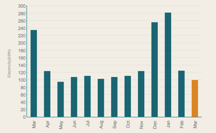

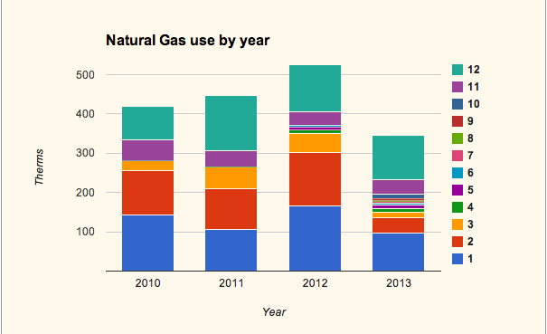

    My house is a circa 20th century sieve, but for the last couple of years I have been making incremental improvements to reduce electricity, and since last year, natural gas consumption. This last year I replaced my electric water heat with a natural gas furnace, and used some of the money saved by not picking solar or condensing furnace to install SE facing windows. My general idea was that the reduction in home air heating would more than offset my increased use of natural gas to heat water, and of course my electric use would drop. The gas water heater was installed ~ September 2012, and the windows by October 2013.
    A year for NG runs from July to July, so 2013 is not quite over. I estimated my anticipated use for the next couple of months. It should be pretty accurate for the year since the lion's share of use is in the winter. As expected, electricity is down from not using it to heat water. Annualized electricity consumption is about 135 kWh a month.
    What next ? I think I can reduce my NG consumption another 33% next winter by increasing solar gain from reflectors outside my new windows (what I think of as a "solar garden,") and improved insulation. That will drop my winter electricity use too since the whole house duct fans will be used less.

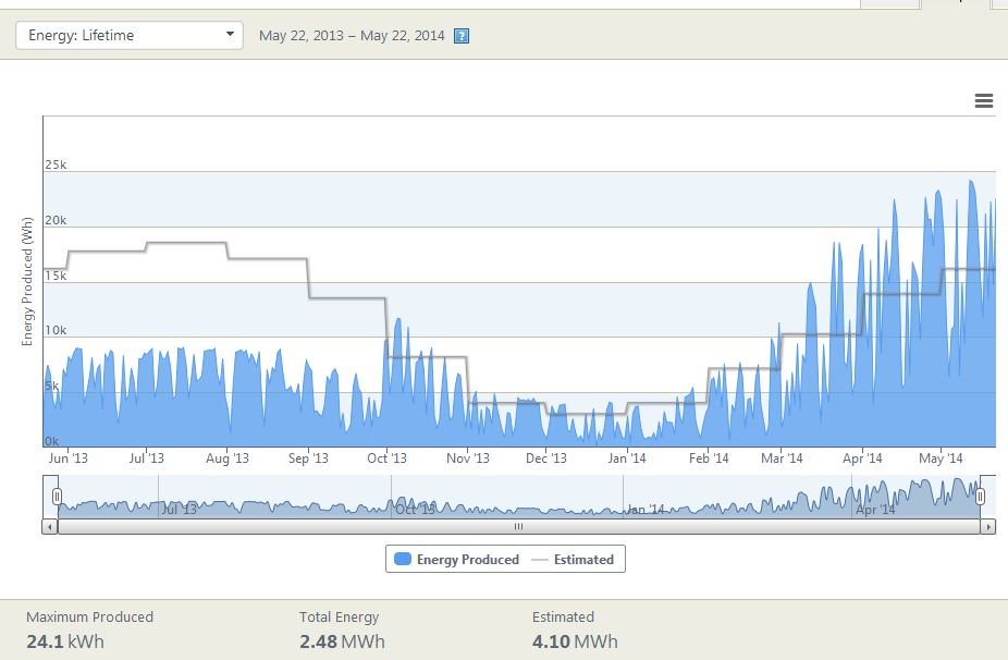

    Last night, my home PV system reached its first anniversary. Here is a daily production graph, also clearly showing when the original 1.6kW was expanded to 4.3kW:
    Blue is actual production. The grey 'Estimated' line is NREL's estimate for a system of this size and orientation, accounting for typical local weather (cloudcover) but not for my tree shading, nor for the smaller capacity during the first summer.

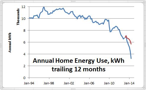

    My serious energy conservation efforts (beyond lowered thermostats and CFL lighting) began in 2006. Here is the progress so far in our all-electric (no oil or gas or coal) home:
    Conservation measures included EneryStar hot water appliances (washer, dishwasher) and refrigerator, greatly reduced air infiltration through the building envelope, some improved insulation, a minisplit heat pump to displace most of the electric baseboard heat, and finally a heat pump water heater (HPWH) installed shortly after the solar PV was energized.
    For the last year, the blue line is the net (billed) electric energy, the red line is gross energy consumption, including PV production. The decline of the red line represents mostly the HPWH savings, along with some additional reduced infiltration.
    Total home energy for the year ended up at 5701 kWh, of which 2457* was produced by the PV, and a net-metered 3244 was purchased from the utility. Once the expansion portion reaches its anniversary, I'm expecting PV production to reach about 3600 kWh/year, dropping the net purchase to not much over 2000kWh/year.
    (* The difference between 2457 kWh at the utility meter, and 2480 kWh at the inverters, is easily explained as conductor loss in the considerable wire distance between them. There might be some meter calibration difference too.)
    This will also mean that our home's net energy bill will be $Zero -- we'll even end up with a rebate -- until June 2020, when the solar incentives expire.
    Our home has technically been 'carbon neutral' since about 2008, when the local utility (90% hydro, ~8% other non-carbon sources) began buying enough offsets to cover its carbon fraction, including its motor vehicle fleet. Now I'm aiming for 'grid neutral' in a year or so. Best guess is, that will need a PV expansion to 7 kW. The roof has space for about 10kW, which should cover a future plug-in car too.
