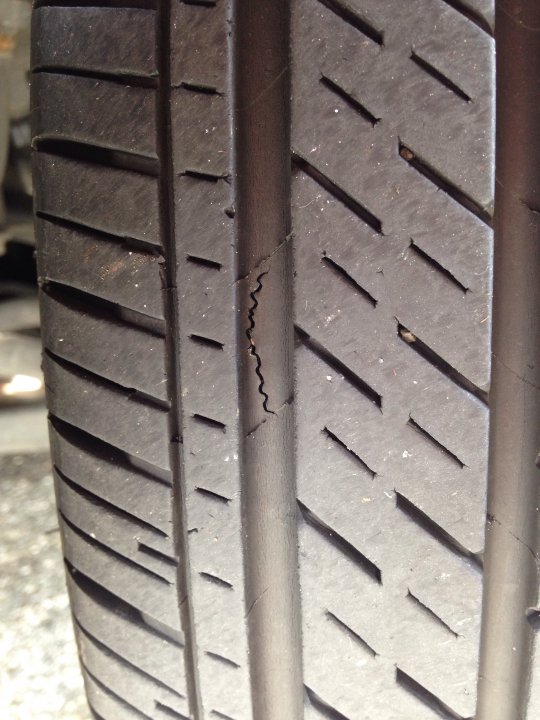

    The wiggly split in the picture is about an inch long. Noticed it about a year back. I thought at first it was an imprint from one of those metal squiggles,the kind they use on picture frame corners.
    Took a pic today, and I'm noticing a lot of micro cracks in the vicinity, and the large split seems to run into those cracks at both ends.
    The tires are the original Michelin Pilots, and the car was built in Aug 2009. Low mileage, just past 50000 kms, with some snow tire use. Remaining tread depth about 7/32".
    Are they past their prime, time for new?

    I wouldn't be driving on that till it was checked. With your driving age is going to catch up before treadwear.

    How deep is the crack? Is there also a bulge? Looks like a weak spot in the tire that could blow out. I would take it to a Michelin dealer for a professional opinion. You may be buying those new Premiers sooner than you planned.

    I agree with afob3, age is a factor here as well as the physical damage.
    Best to get it taken off the rim to examine the tire from the inside opposite that odd split. As it is within the groove, there obviously is less rubber until you get through into internal belts.
    In terms of where you and I live, it is all too easy to hang onto tires for too long especially if one uses snow tires for 6 months of the year. On the one hand, people don't want to toss tires that still look okay even though they are 6 years old, so they tend to cheap out... but they have no problem buying a second set of tires and rims to use in an environment where winter is a fluke occurrence. If we were consistent, the old tires would get tossed... likely the snows are just as old and also "look" new.

    No bulge. Just some fine cracking in vicinity. I just now pushed a fine pin in: goes about 1/8" easily, then stops. So doesn't seem like the walls are just tapering down. More like its bottoming at that point. Hopefully not just wishful thinking.
    It's looked thus about one year now, at least since I noticed.
    But yeah, they are getting on.
    Yeah Roland, between our low usage and swapping over to snows, tread depth will be lasting another 4 years, lol. I'll think on this.
    Costco's outa Michelin Premiers right now, do have Ecopia EP422. Its 225/44R17 I'd be looking for.

    I'd probably hit it with soap solution to see if it was leaking.
    Looks like this right?

    It's holding air ok, but yeah I Should try soap solution. That's the metal item I was thinking of. Not sure cus the wave cut seems irregular.

    I think those tires are past their prime.
    I think it's time for new.

    I once had a tire that had a similar crack in the sidewall, no bulge. The tire dealer said it was just a cosmetic defect in the outer rubber cover and OK to drive. I would still have the tire inspected by a Michelin dealer before condemning it. Maybe it is not as bad as it looks.

    Well it's looked like that for a year now. Likely longer, that's just when I noticed it. And not losing any air. Everything was fine, 'till I happened to park with the wheel turned sharply, and noticed it again, lol.
    It can't be a good thing, but it seems stable. Ok, resolved: next time we're at Costco I'll see if someone can look at it. The tires are largely crack free, but just in vicinity of this split there's some. Like the rubber composition's locally messed up??

    The tires are from 2009 and exposed to all the elements. It's deteriorating and it shows. Safety first.
    I personally would not even bother getting them inspected. It's time for new tires. Just saying.

    They're strangely crack free, well apart from this zone. When we found the car on the lot it was in a large, covered shed, at the back of a batch of cars, dusty, with a dead bird beside it, lol.
    And it's garage stored, and these OEM tires spend 4~5 months each winter in a stack in the garage, with kosher tire cover over them.
    But yeah, hear what you're saying. The tires will be at least 6 years old, come august.

    It's the belt structure that keep the tire together. The lack of a leak would say a lot as well. What's missing is a load test since you haven't driven on it.

    It's looked like this for over a year, and not losing air. And doesn't seem to go deep, testing with a pin. Guess I'll just keep an eye on it. Thanks.
    Edit: did the soapy water test, no bubbles. Pretty much a given, the tire's not losing any air.

    It is a pain to test but clearly it's a cut and not just crack from dry rubber. So how deep and bad is the cut? As you found, not deep enough to penetrate as it still holds air. Did it damage the structure(belts)? No bulge so that another good sign. If that meet your critirea, then you're ok.. if not take it for the last test you can do, drive on it(load test).

    Yup, it's been driven, this is old cut. A slim pin will push in about 1/8", then stops, abruptly too.
