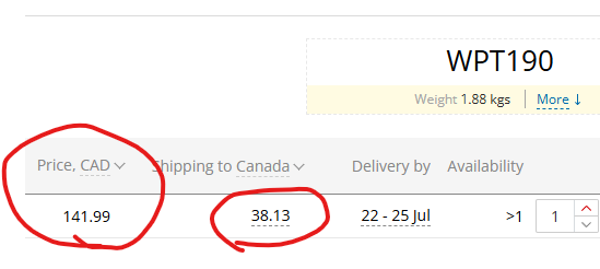

    From what I've found Aisin is oem for Toyota. Is there any reason to buy a toyota branded one from the dealership over an Aisin one from RockAuto? (My account is too new to post links, sorry)

    Actually nvm, I'll get it from Toyota as it's only a little more expensive.

    99% of rockauto is chinese junk. If you buy it from Toyota, you know you are getting oem.
    How much is the price of a new engine, and labor, that seizes because the chinese copy coolant
    pump fails? Plus, leaving you stranded somewhere?

    I bought my aisin water pump on Amazon for 148$ with 7$ discounted coupon. It’s been working fine.
