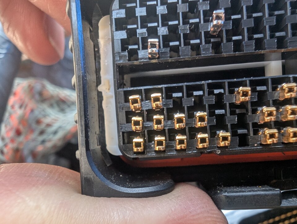

  5. HuskerABSG75
    HuskerABSG75 New Member
    Yesterday
    Kingsland, GA
    I snuck a couple strands of wire under the connector and found 5V. The connector holes have been rounded open like someone used fluke leads that were too big for the hole. Now to figure out how to get this connector apart. I just watched Haltech Dave's video on depinning connectors and Tyco is featured, but he depinned a little guy, not this monstrosity. PXL_20250626_192344823.jpg
