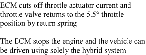

    The fail-safe response for the ETCS codes is supposed to be:
    If you keep driving after that happens, you're using only battery power to move the car, and there is only enough in the battery for a quite short distance at low speed before you'll get a warning about that.

    You're right, it it P0121. I need to edit it. Thanks. Yeah, and when the hybrid warning comes on, it can go only a short distance.

    ChapmanF, you're right. Don't know why I got dyslexic on the code. It is P0121. If the ECM stops the engine, why would it give a warning about the hybrid system rather than you're on battery mode only? Edit button is gone. Will try to find out how to contact a moderator to edit that. Gonna try to clean out the throttle body, or change it out. See if that fixes anything. Thanks.
