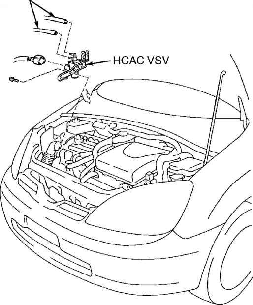

    Found the switch for the vaccum hose is in the engine compartment on right side by throttle body. Perhaps could try and put a little diaphram on it and see if that works to stop the error?
    The 02 could possibly detect the downstream change.

    Here is where its located Near the DRZ-A and BH2, behind the GRG/KN and PT. TLA GL :)
