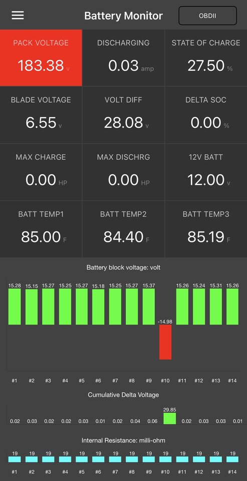

    An update: The car drives but with a P0A80. All HV modules look great except for module #10 as evidenced by a Dr Prius log. What happens is the SOC number shown will suddenly drop from 60% down to 25%. Only #10 falls 2V lower than all others and looks like it needs more high voltage balancing.
    SM-A536V ?

    Module #10 looks like it has a reversed cell(s)
