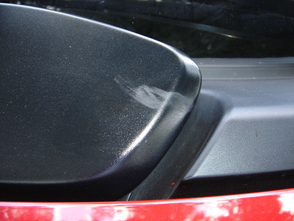

    After my great luck with the painted parts, I figured the plastic and trim would be even easier. Not so! The Goof Off removed the paint, but it also ended up melting the plastic and removing the paint from things like the windshield wiper arms. Not good. My first effort really marred up some front cover thing below the windshield. (See Photo). I soon discovered that a tiny amount of Goof Off applied, and then immediately wiped off would remove the paint and take just a tiny layer of plastic with it. By doing an entire part at a time, I could dissolve the part equally all over so there was no sign of my cleaning.

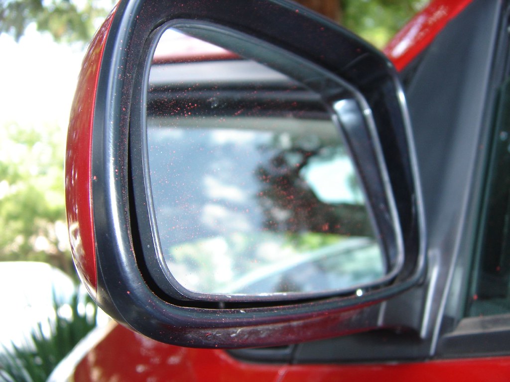

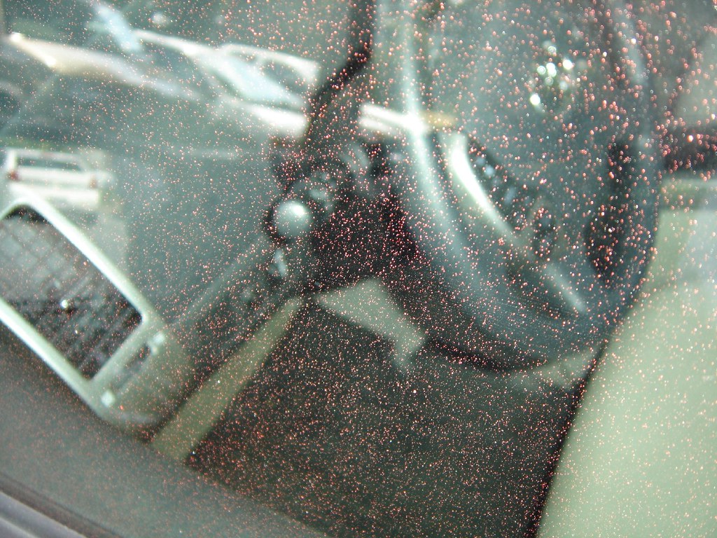

    I worked on this for a couple of hours and removed about 75%. I was tired and a bit frustrated so I saved the rest for tonight. I didn’t take a picture before, but here are two pictures taken today. The window picture shows how much was sprayed at that level. Lower was MUCH worse, especially as the door flares. The lower half of the door was nearly covered entirely.
    All I all, I think I will be ok. Sharing this odd tale at least allows others to know that Goof Off removes paint. Just don’t use it on plastic, trim, or rubber.

    well there's a bit of foreshadowing for you.. Sucks. But the glass should be very easy.. a nice, new, clean razor blade should do the job.. Plastic?? I do not know man.

    Thanks everyone for the tips and ideas. I spent some more time last night getting the windows clean, using pure Goof Off. It worked pretty good and I got most of the windows nice and clean. I plan on tackling the trim and plastic parts tonight. I'll try some of your thoughts during this process.
