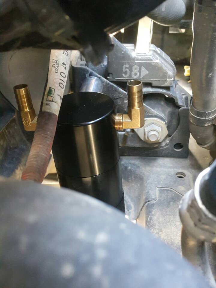

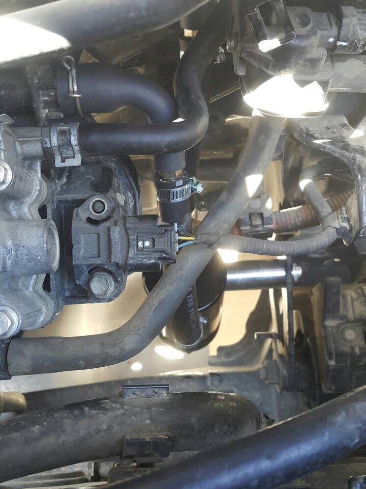

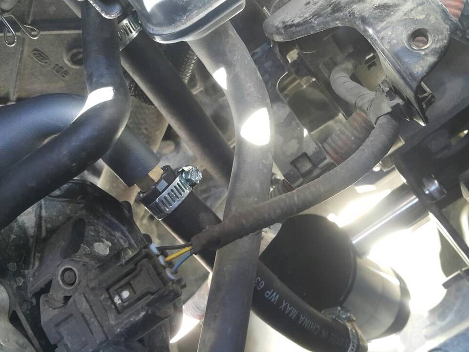

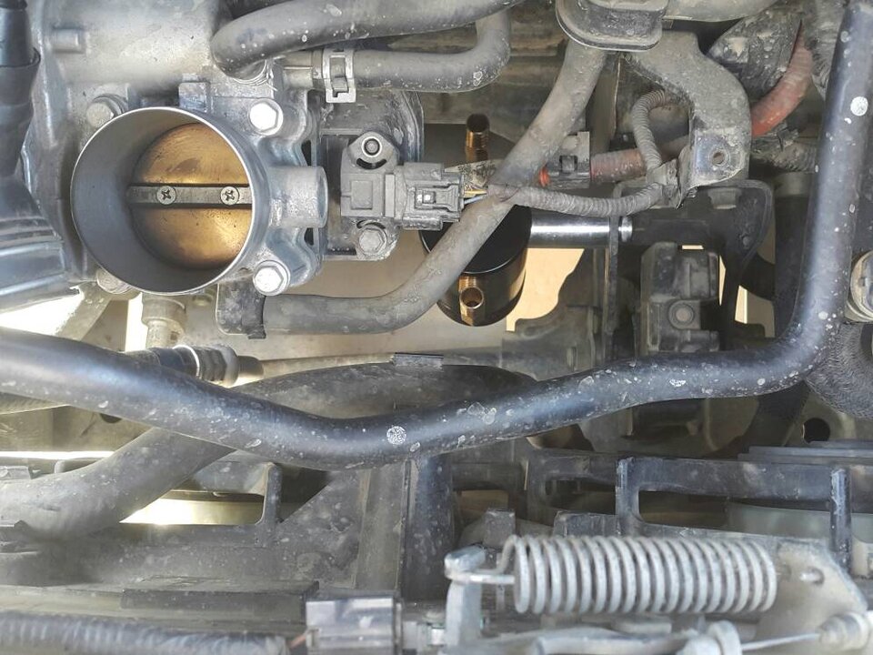

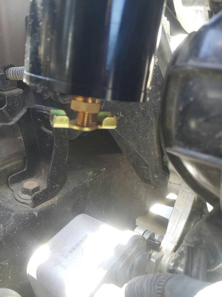

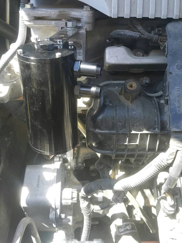

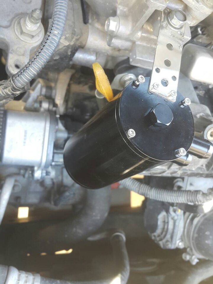

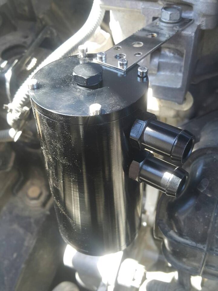

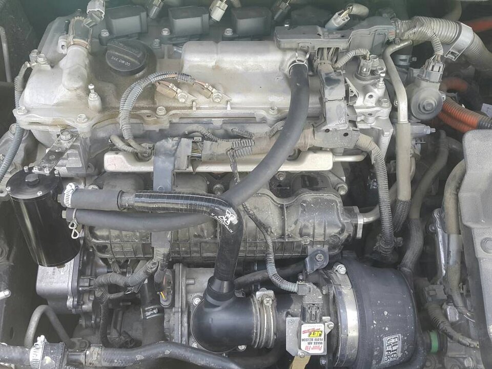

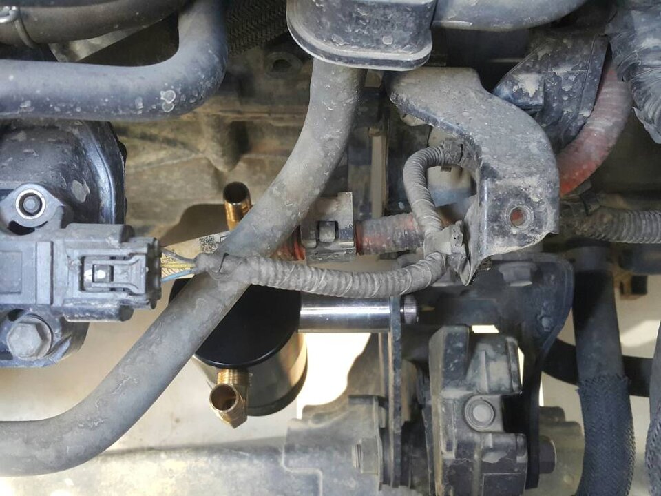

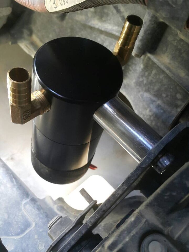

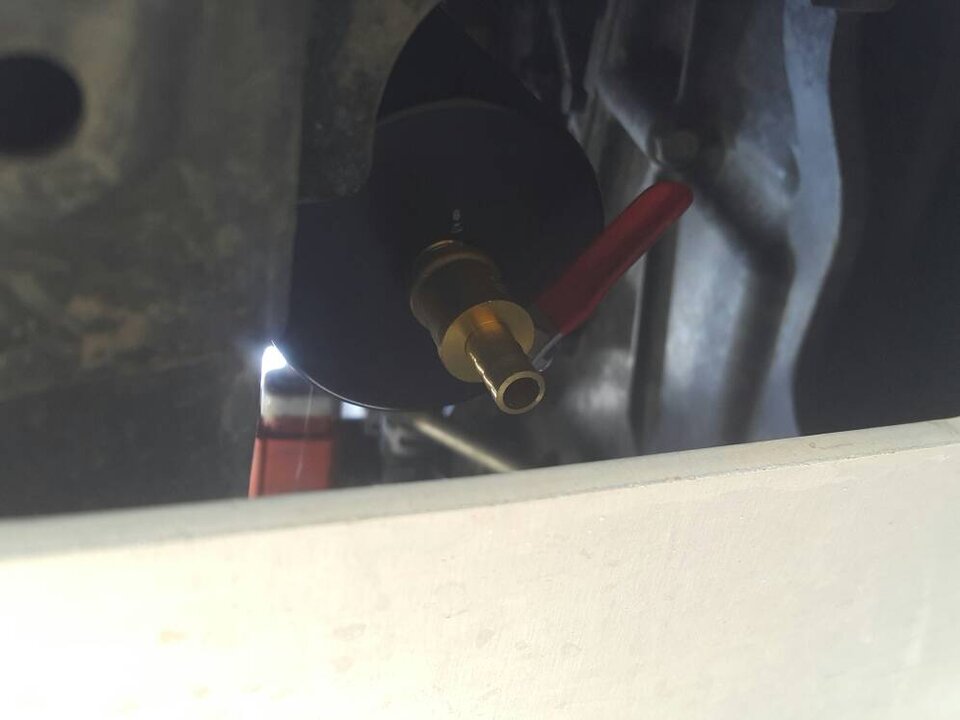

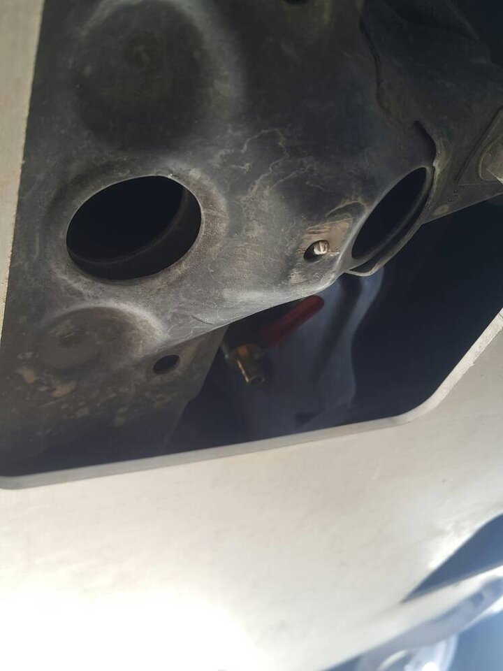

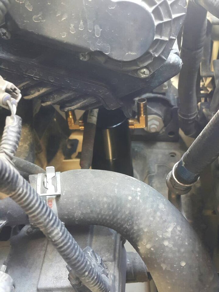

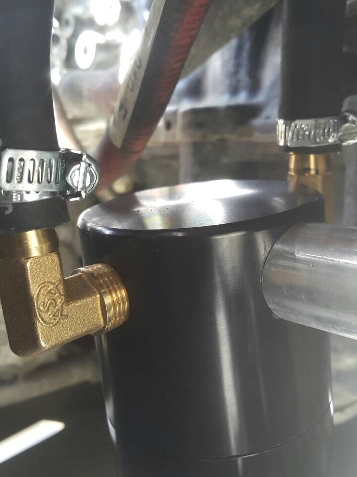

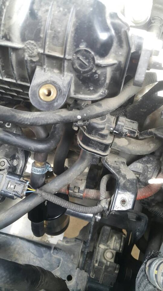

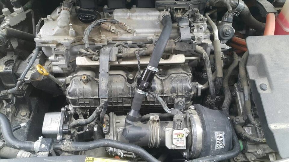

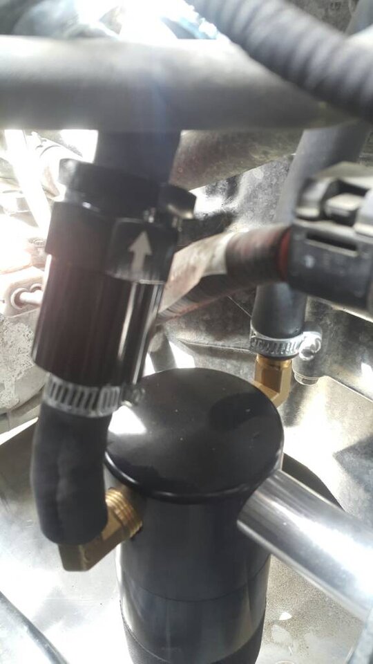

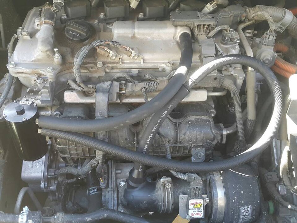

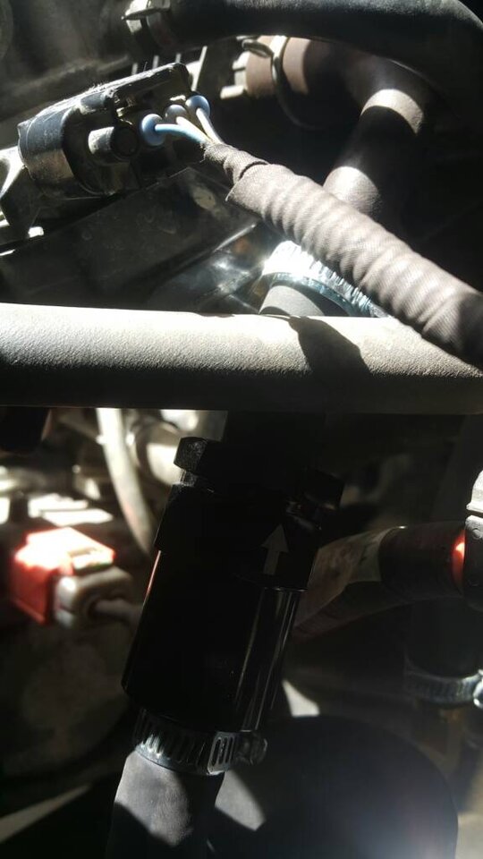

    I have brought this up in the forums before and I believe this to be the best oil catch can setup you can do.
    I used the best locations I could for this type of setup and the OCC I had.
    For the PCV catch can, I was inspired by a post from @sLick415 which gave the best location for a stealth setup for Cali smogs.
    Ther are a few others on here who have adapted this location and they are the following.
    @Tekken
    @tacopyro
    @HappyDad701
    @tri4all

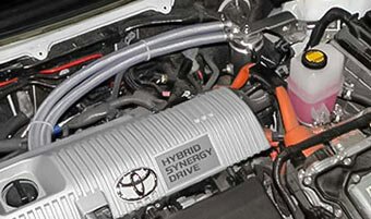

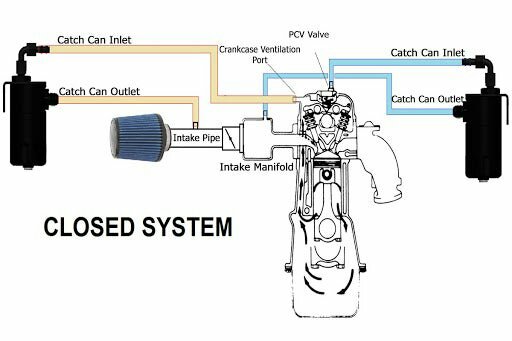

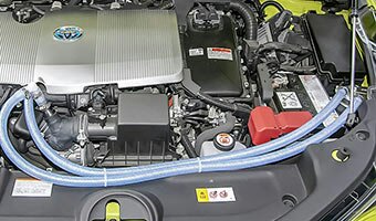

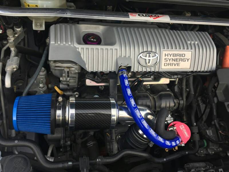

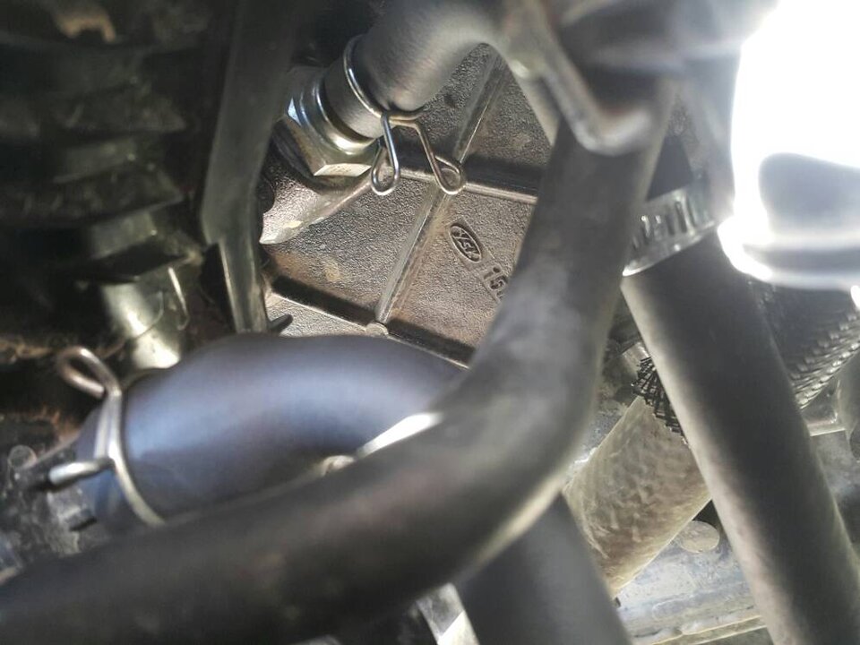

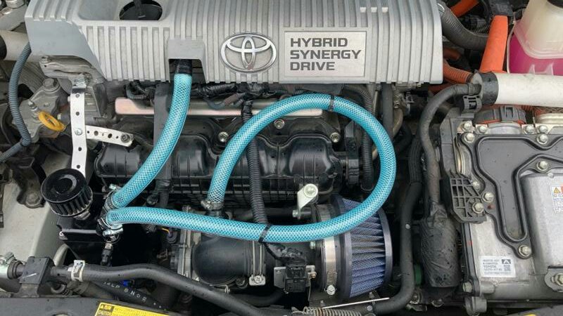

    For the CCV I was doing research online and came across two images that show a catch can on the breather hose.
    This a vacuum on WOT which the prius is usually high rpms and I have a bored TB.
    So I have done a setup with both.
    I know @danlatu had some ideas with messing around with putting another PCV on the valve cover or relocating it to the breather hose.
    I managed to do this without removing the intake manifold and in the near future will be updating the intake manifold to the latest version.
    Stay clean!!! 20260324_130930.jpeg 20260324_131144.jpeg 20260324_131208.jpeg 20260324_131509.jpeg 20260330_151930.jpeg 20260326_140843.jpeg 20260326_140802.jpeg 20260326_142529.jpeg 20260326_140935.jpeg 20260326_142421.jpeg 20260326_142616.jpeg 20260326_142803.jpeg 20260326_143033.jpeg 20260329_122008.jpeg 20260329_121926.jpeg 20260329_121916.jpeg 20260329_122026.jpeg
