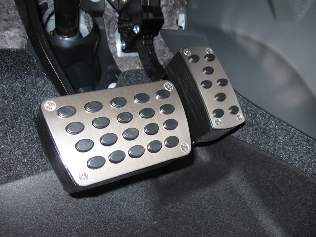

    One of the first things I did when we bought our ’05 Prius was to fabricate a pair of brake & gas pedal extenders, since otherwise my 4'8" wife would only sit a few inches from the steering wheel. I was hoping we wouldn’t need them for the new Prius v, since this car has some features that were lacking on the ’05, such as the telescoping steering wheel and advanced airbag system. Unfortunately, it seems what she really needs is a “microscoping” steering wheel, since we have it all the way in and she is still too close to the steering wheel (in my opinion) when the seat is adjusted so she can comfortably reach the pedals. In addition, when she has the seat adjusted this way, it is so far forward that she has to slide it back to get in & out of the car.
    So, it was back to the workshop again, but this time I had the benefit of lessons-learned from the previous project. First, we had to visit a few auto parts stores to find a pedal kit that was the right size and didn’t look hideous. Fortunately, we found a nice set for $15. I never liked the little grabby clips that come with these pedal sets, although I used them (with some modifications) on the old Prius. In the new car, they turned out to be completely useless because they’re not long enough for the brake pedal, and can’t be used on the gas pedal because it is a one-piece molded unit and there’s not enough material on the back of the pedal for the clips to grab onto.
    My goal was to fasten the pedal blocks in such a way that they’d be very secure without having to drill any holes in the gas or brake pedal assemblies. This required a couple of trips to our local industrial fasteners supplier for stainless screws, washers, coupling nuts, and nylon-insert lock nuts, plus a few pieces fashioned from furniture corner braces & other parts from my junk drawer.
    Same as last time, the most time-consuming part of the project was shaping the blocks made from 2x4’s to match the compound curves of the new pedal covers. For the old car, I did this on a friend's bench disc sander, but it occurred to me that I could achieve the same result by clamping my belt sander upside-down in my Black & Decker Workmate, which worked beautifully. I also mortised out the back of the brake pedal block so it would lock onto the metal plate with the rubber cover removed. The plastic piece shown below was my template for chiseling the mortise, which also had to be concave to match the factory pedal. The four sheet metal screws clamp it in place at the edges, then the two L-brackets ( > and < ) provide additional bracing. As you can see below, the gas pedal attachment is a bit more convoluted, but it’s rock-solid and if necessary, the whole thing can be removed without leaving any sign it was ever there.

    The individual parts for both pedals

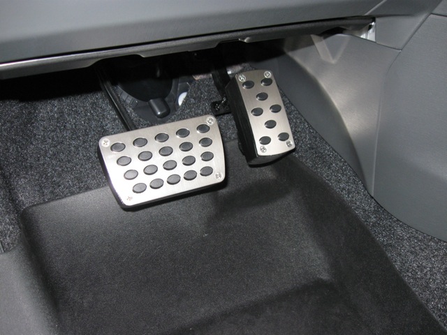

    Fully assembled
    Another view
    We’re both very pleased with how this project came out, but I sure hope our next new car has adjustable pedals so I never have to do this again!
