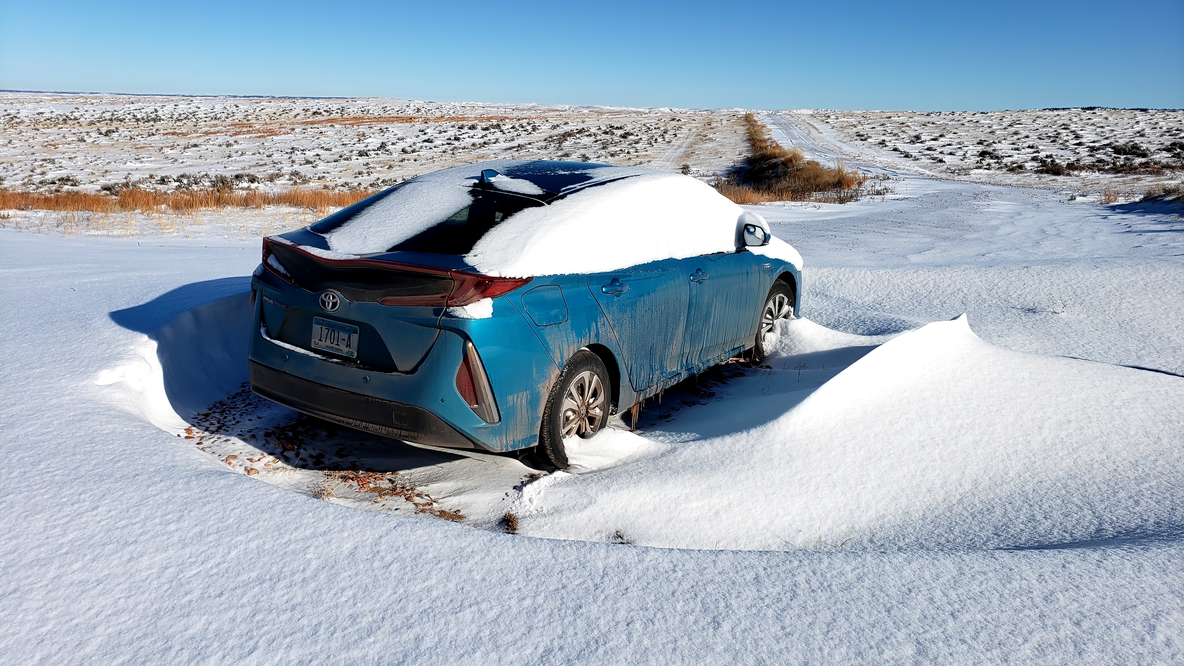

    Wyoming here, with a 2019 (Gen 4) Prime that's even the same color as @john1701a. I also have a regular type 2011 (Gen 3) and used to own a 2009 (Gen 2). We've probably got 200K miles on our Prii, a lot of that in the Wyoming winters. The only time I've had any issues with starting was shortly after I got the 2011. It had a chewed-up cable going to one of the O2 sensors. Once I replaced that, our cars have started up without issue, even in the coldest weather (around -30 F is the coldest I remember).
    We're high desert here, so the weather may be a bit different than where you are. Typically, we get a week or two of subzero weather, but at that temperature, it's usually too dry to get all that much snow out of those weeks. We also get hit with the occasional deep snow, but that's usually when it's a bit warmer. This is a dry climate, so when we get hit with a cold blast, it usually warms up a couple days later so it's not a really sustained cold (usually).
    With our Prime, the charging is usually done in the garage, so it's going to be less cold when my wife starts up the car in the morning. Since she's got a 50-mile (one way) drive, she uses the ICE to get the car warm before switching to the EV for part of her trip. Between the snow tires (studded), the cold, the wind, and the fact that her miles are mostly on 80 and 70 MPH highways, the EV range is down to less than 20.
    That said, most of our cold weather difficulties with the Prii in the winter come from the lack of ground clearance. It's no different than any other of the cars these days. As winter progresses, I notice more things dangling from under everyone's vehicles, including the later model pickups and SUVs. I'm sure it's the same there, or maybe a bit worse perhaps. Other than that, we've had a lot less trouble getting them going in the cold than our previous ICE vehicles (including the 4x4 pickup truck).
    I suppose if you wanted to be extra sure, you could put the car in CHG mode for the last few miles before you shut it down the day before to put a bit more energy in the traction battery (and you're not going to be hooking it up to a charger overnight). We've never found that to be necessary, though.
