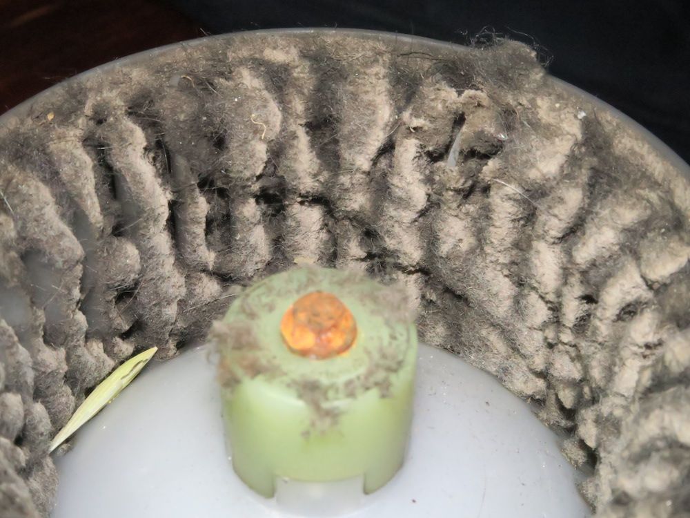

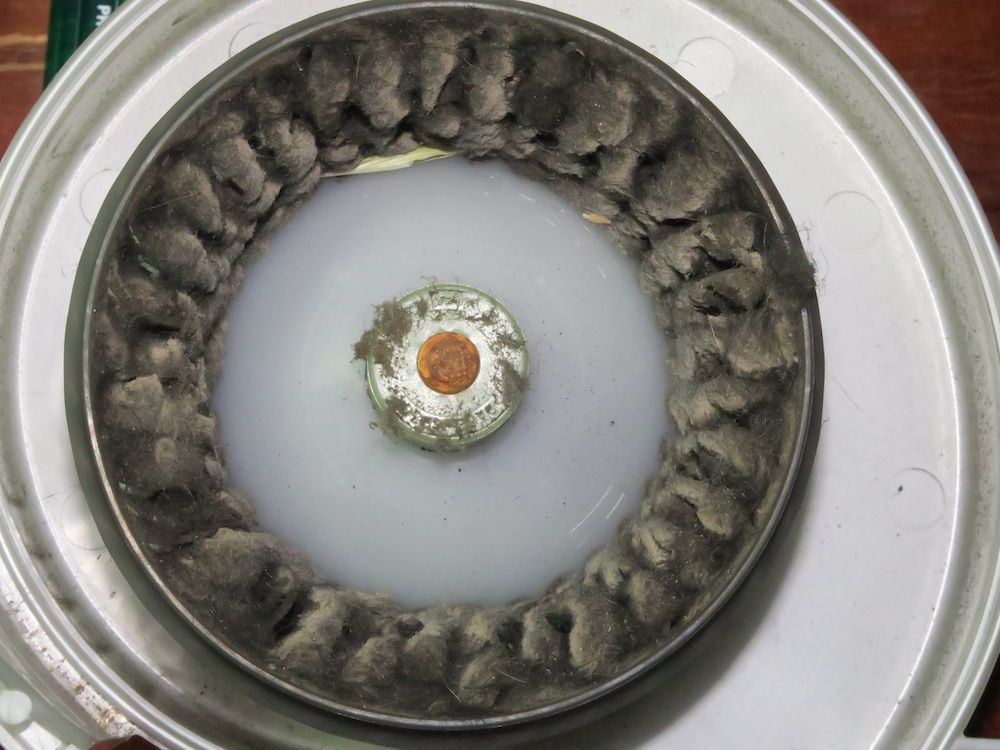

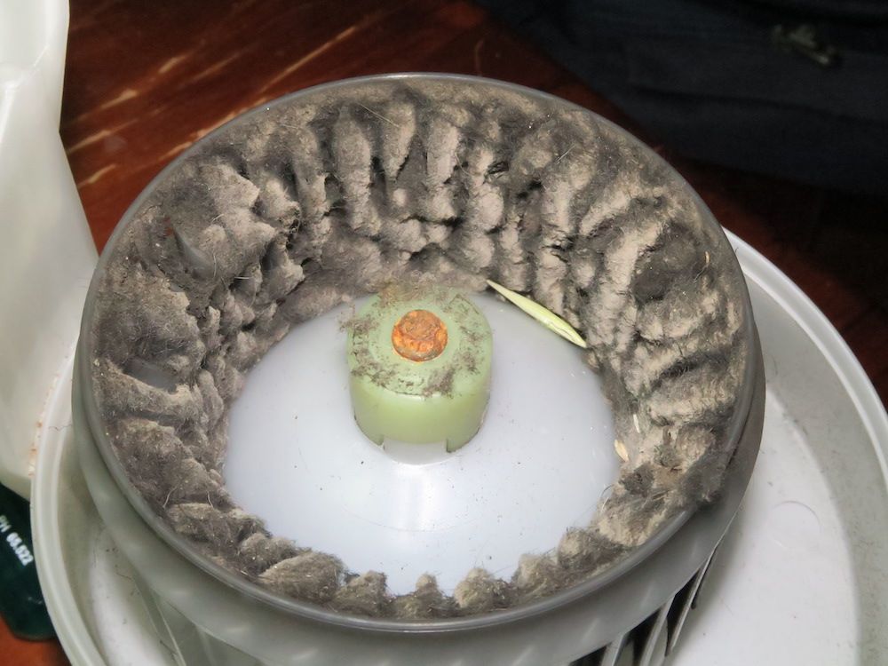

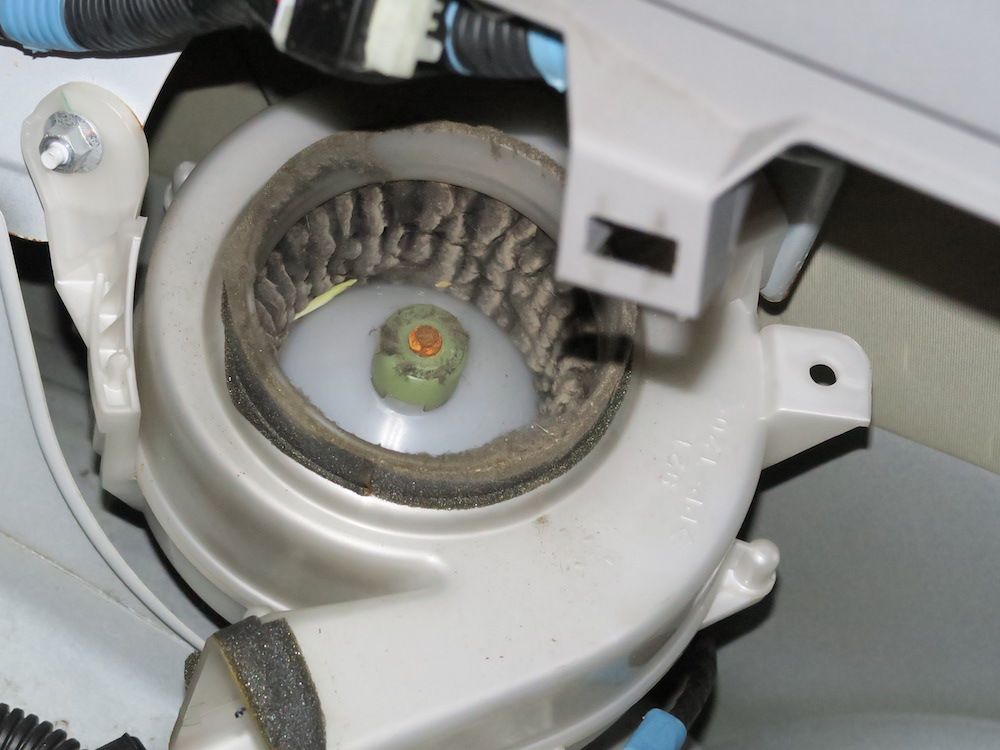

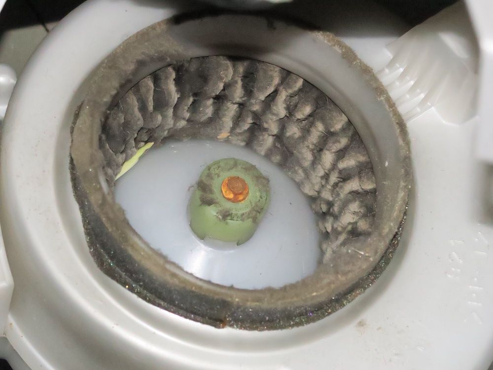

    Check out the photos - probably the worst Prius fan I've seen.
    Almost no air would have been getting through.

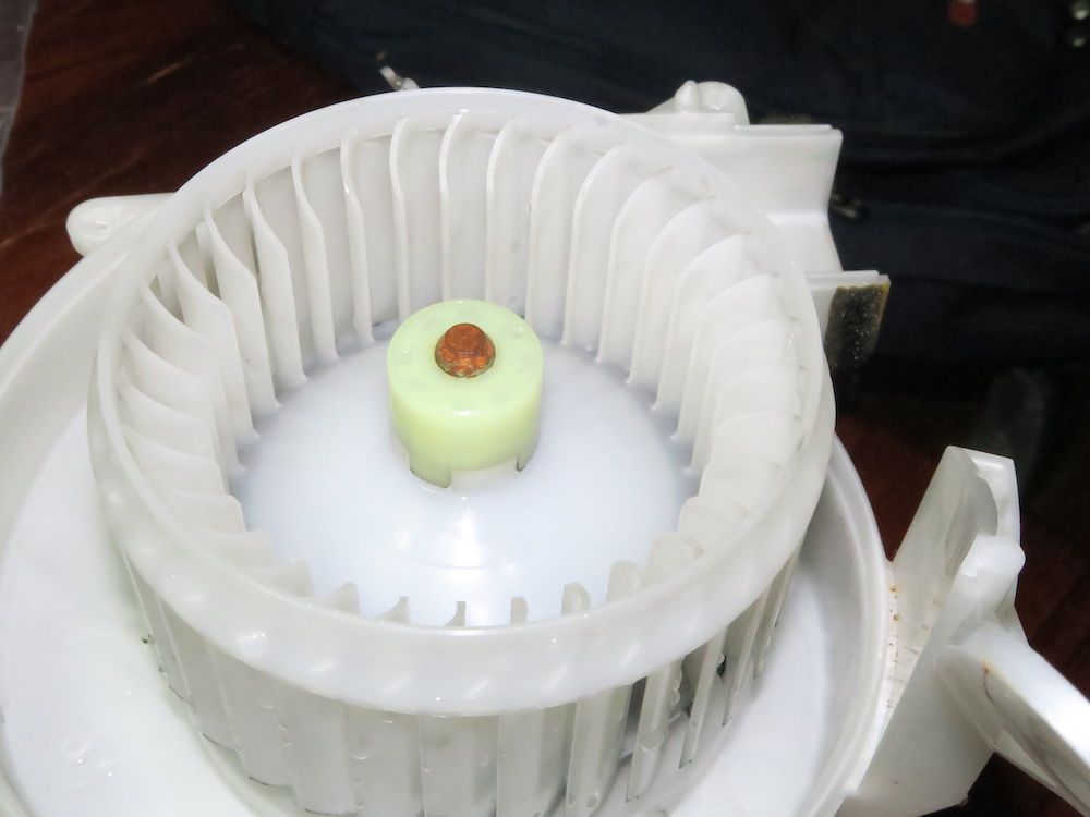

    I already had a spare clean fan so I fitted that one.

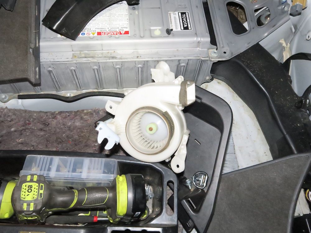

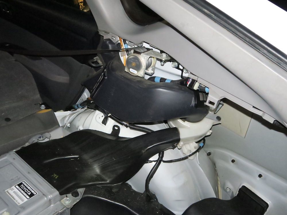

    The replacement fan in place.
    With the fan cover removed.

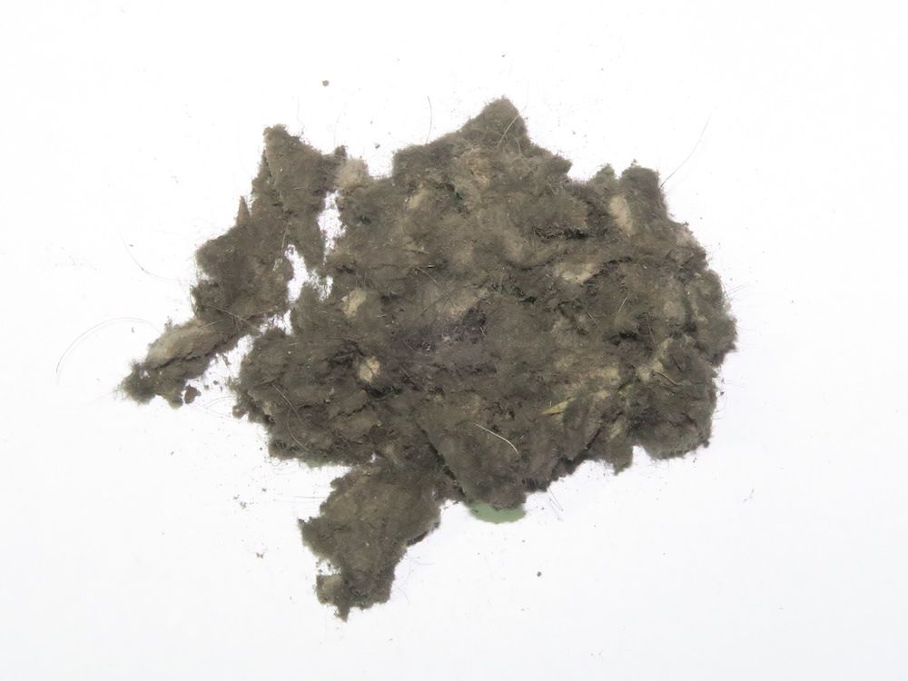

    A lot of the gunk was easily removed with my fingers but it felt rather awful.

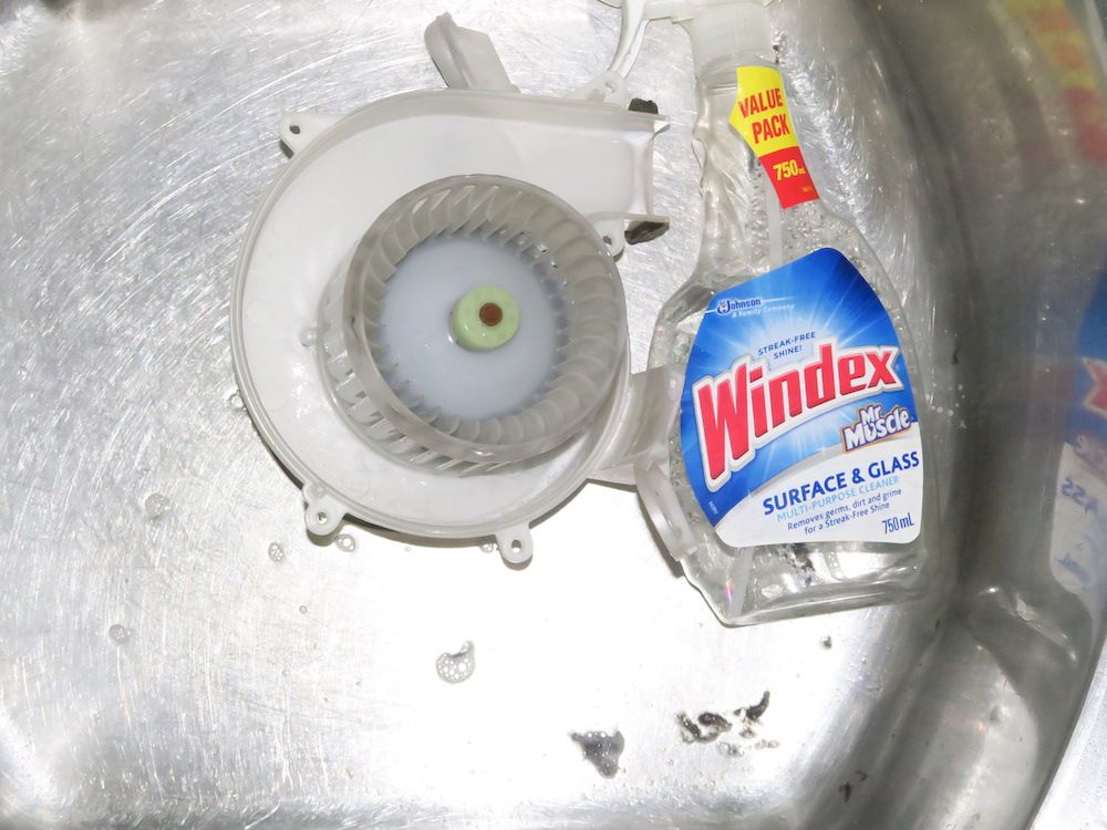

    Then I got a commercial-level steam cleaner, which cleans a fan to almost new condition.

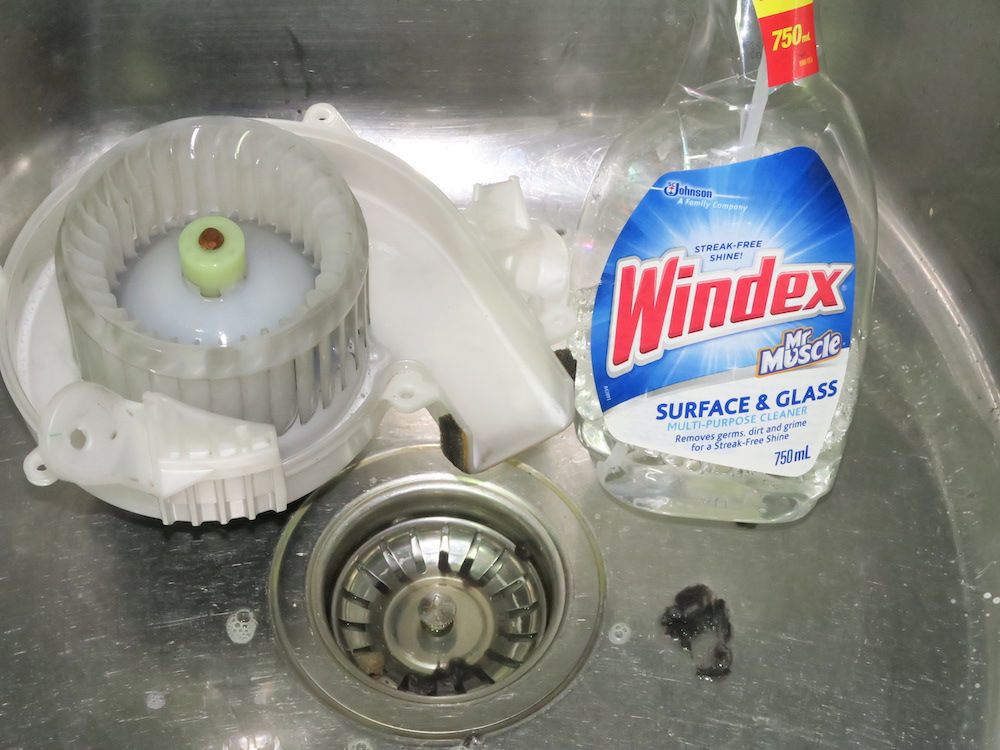

    Recently I tried this stuff (Windex Surface & Glass) and am amazed at how good it is for cleaning fans.
    All I did was spray a bunch of into the muck and then rinsed it all out with hot water in the kitchen sink.
    Within a couple of minutes the fan looked almost like new.
    I'm in Australia, and don't know if this stuff is available in other countries... but next time you're cleaning a battery fan try whatever surface cleaning spray you've got in the kitchen.
    You can see some of the removed dust in the sink and in the drain.
    Not bad. No tools. This took seconds to do.

    I hold the fan with one hand on an angle so that the tap water goes through the blades but not into the motor area. I use my other hand to spin the fan.
