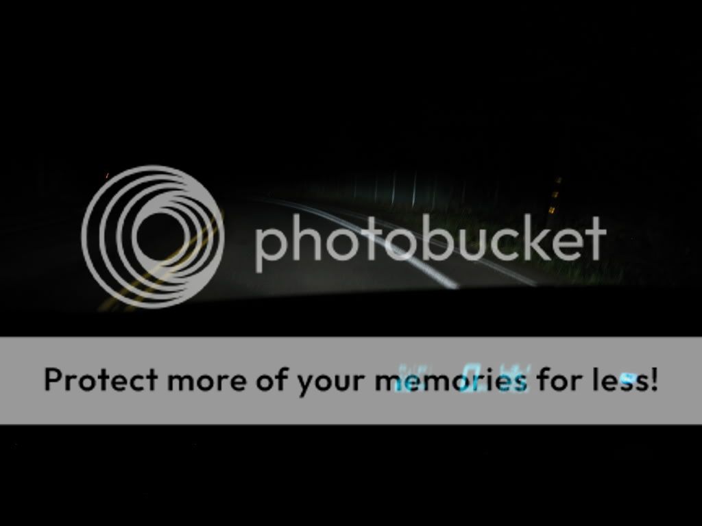

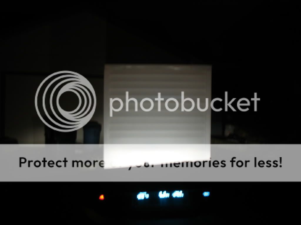

    Here is the Fog Lights Only Pattern on screen and road.

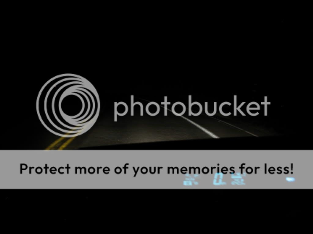

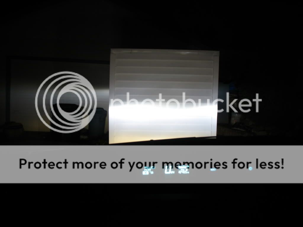

    And the Combined Headlights and Fog Lights on screen and road.

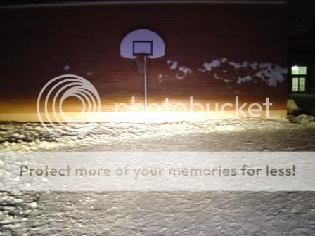

    His photo PIAA Ion Crystal Yellow fog light only.

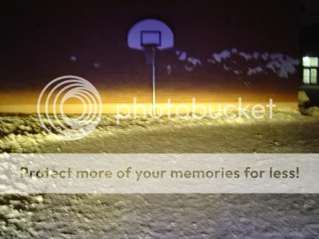

    And his photo PIAA Ion Crystal Yellow fog light with headlights.

    Thanks for the photo. Looks like the reflector on the fog light is not very efficient. There isn't a very defined pattern.
    I used the Silverstars on my Volvo's foglights and it had a very defined cutoff and well spread pattern. In my Prius, the fogs just throw light every which way. I have mine adjusted pretty high up, too.
    I think the best solution is to pull the factory fog lights and replace the entire unit, housing and all, and replace it with a better designed system.

    Do you think that maybe the standard bulbs are just too weak? I actually thought the pattern looked fairly good, and was looking forward to trying it out with upgrade bulbs.
    Look at the pattern on the screen (my utility trailer at about 5 feet and garage door at about 20 ft - pardon the dark light absorbing trash containers. The pattern looks pretty rectangular to me, but if you have seen better, perhaps it might not compare.
    I will try to find an all white wall to show a better view of the pattern. By the time it hits the road, I am not sure you can expect super clean edges on the light pattern. I may get some of the housings you pictured too and compare them side by side.
