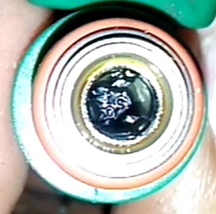

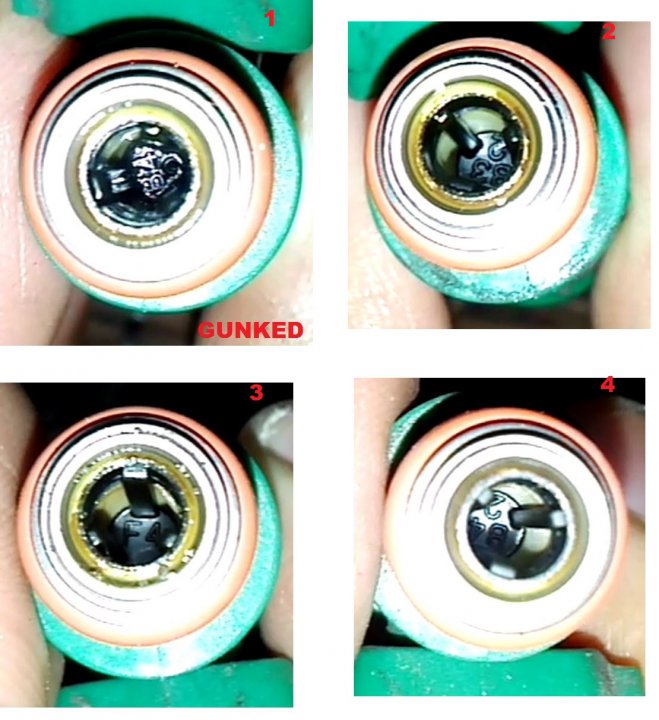

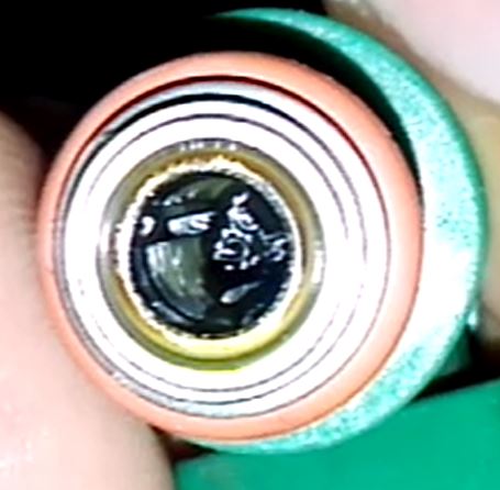

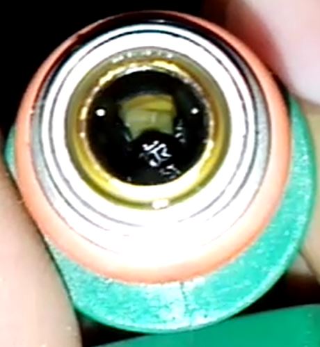

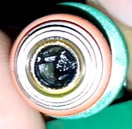

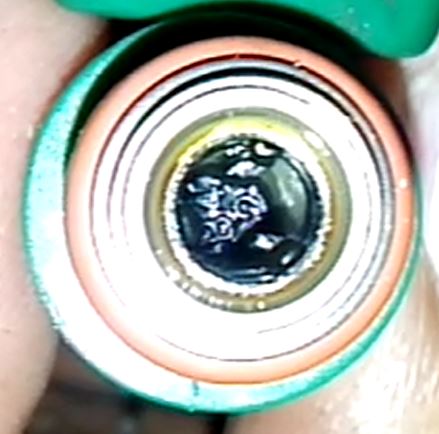

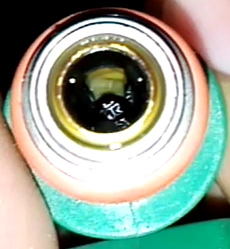

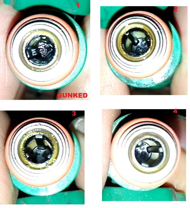

    If you have never seen one, here is the picture of a clogged fuel injector which was causing performance issue and got fixed after replacing it. The # 1 is clogged, you can see how the consistent and cleaner the other 3 are. Car has 92K miles, used Arco gas 98% times. Never used a bottle of fuel injector cleaner until 87K. Here are the symptoms that got fixed by replacing the injectors,
    1) Loss of power from Engine (sounded like engine is revving high but the speed attained would be low)
    2) Louder than usual ticking sound from Engine
    3) Engine sound louder than normal
    4) Ran better with additives in tank (like Techron, Lucas, STP fuel injector cleaners)
    here are a few more of only the clogged one.

    great pics, thanks. 120k on my neighbors '04, 55 mpg, no drivability problems, never used an additive. no idea on the state of the injectors, what do you think is a probable cause?

    I think most likely it is the Arco Gas that caused this on mine. What Gas does the neighbor use on a regular basis?
    I have decided to get only Chevron going forward and use a bottle of Techron Progard every 5K miles just before changing the oil.

    Arco is a Top Tier gas however the cheapest one. I am really not sure what could cause this, something got dropped into my tank when I was refueling maybe, hope the same does not happen to my new injectors. I will just have the old ones cleaned professionally and keep it as spare. :)
