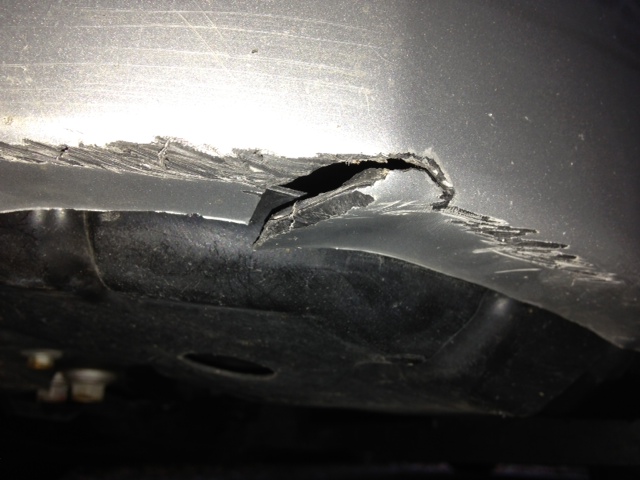

    An old thread, but better to reply here than start anew, right?
    I just got a 2010 Prius, and found the small rip (see attached) in the corner of the front bumper.
    If I understand correctly, the bumper is pretty easily removed, and I guess I'll try glue or epoxy after roughing-up the interior. Maybe add a thin reinforcing material to the inside.
    Any better ideas? Thanks...Lyle

    29
    lol, how do you go from "cracked" to completely torn the f up!? No, that cannot be repaired properly. You can use some sort of industrial plastic glue, but it'll look awkward.
