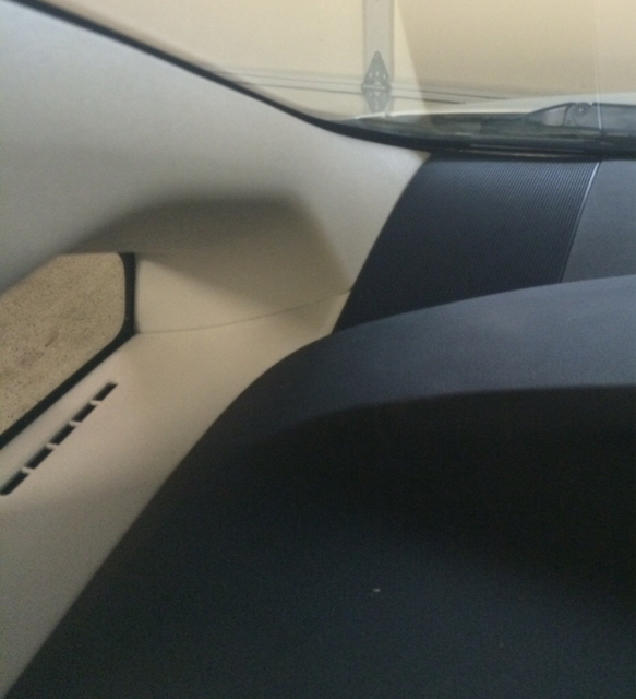

    While installing new dashboard speakers today, I found something interesting: When you remove the A-pillar cover, there's a cover beneath the small triangular window. This piece is vented to let the defroster warm the glass. Remove this piece, and beneath is a small plastic "cup." Mine had something inside. Presumably, something fell inside the vent, landed in this little cup, and it's been rattling away for years. I shook it out, now that rattle is gone.
    In the photo below, it's the small tan piece of plastic with the five slots.
    Thomaus, hamocidal and sprtent like this.
