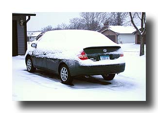

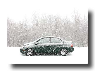

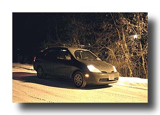

    3 winters in Minnesota, I did absolutely nothing to prepare my 2001.
    Kind of boring, eh? The Prius just fired right up... even after sitting out in that horrid cold all day while I worked. For more heat, you could block the grille. But that's totally optional and something I didn't do. To reduce the startup MPG penalty, you could install an Engine Block Heater. But I didn't do that either.
    Lots of photos available on my website, by the way. For example...
    [​IMG] . [​IMG] . [​IMG]
