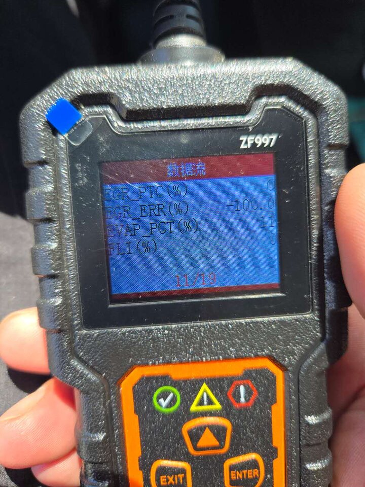

    Does this mean the EGR valve is stuck?
    Idle, maintenance mode, let the water temperature rise, the cooling fan starts running, and the EGR data does not change

    At idle, the EGR is fully closed on the Prius.

    The information that you found on Google is not correct.
    If you are looking at live data for the EGR valve when the engine is idling, you will not see any change in the data because the EGR stays closed at idle.
    What are you trying to do with the EGR?

    EGR_ERR: This data is the difference between the expected EGR and the actual EGR

    I have no idea what your scan tool is showing for the EGR data. Maybe someone else can help you.
  12. ChapmanF
    27,612
    18,208
    That scan tool seems not to even know what kind of a car it is talking to. A gen 3 Prius does not report EGR information in that way.
    Perhaps there is some way to get that tool to show the result of the mode 6 noncontinuous monitor (module ID 0x31 test ID 0xBD) that the Prius uses. It should look like examples you see in this thread.

    The data that your scanner is showing about the EGR valve is not meaningful.
    I will ask again. What are you trying to do with the EGR valve?
    If you just want to see if it opens, take a look at post #12.
    If you want to check if the EGR valve is not closed and it is causing the engine to run rough at idle, then remove one of the two screws on the pipe downstream of the valve. Insert a putty knife to block any possible flow. If you search on YouTube, you will find a video about this.
