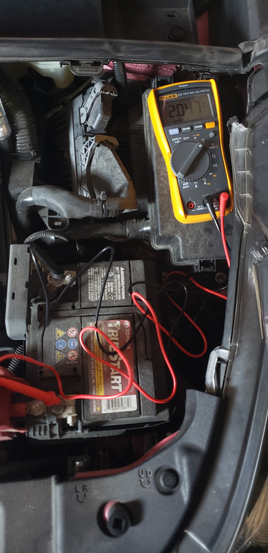

    Your video definitely looks like the car is drawing more power than your Weego is supplying, trying to complete bootup of things, and caught in a cycle of that. Have you made sure to turn off as many electric loads in the car as you can? I've also been known, in dire circumstances, to pull the fuses or relays that power the brake pressure pump, and just put them back after the car is successfully readied.
    Sometimes there can just be extra resistance in the contact your clamps are making with the posts; I've got a habit of wiggling them around some to make a better connection.
    Two volts on the car's battery is really low. A bunch of power from your Weego is just being slurped into there.

    I noticed that, too. It's a really dead battery. But with the green light, I'd think it ought to work.
