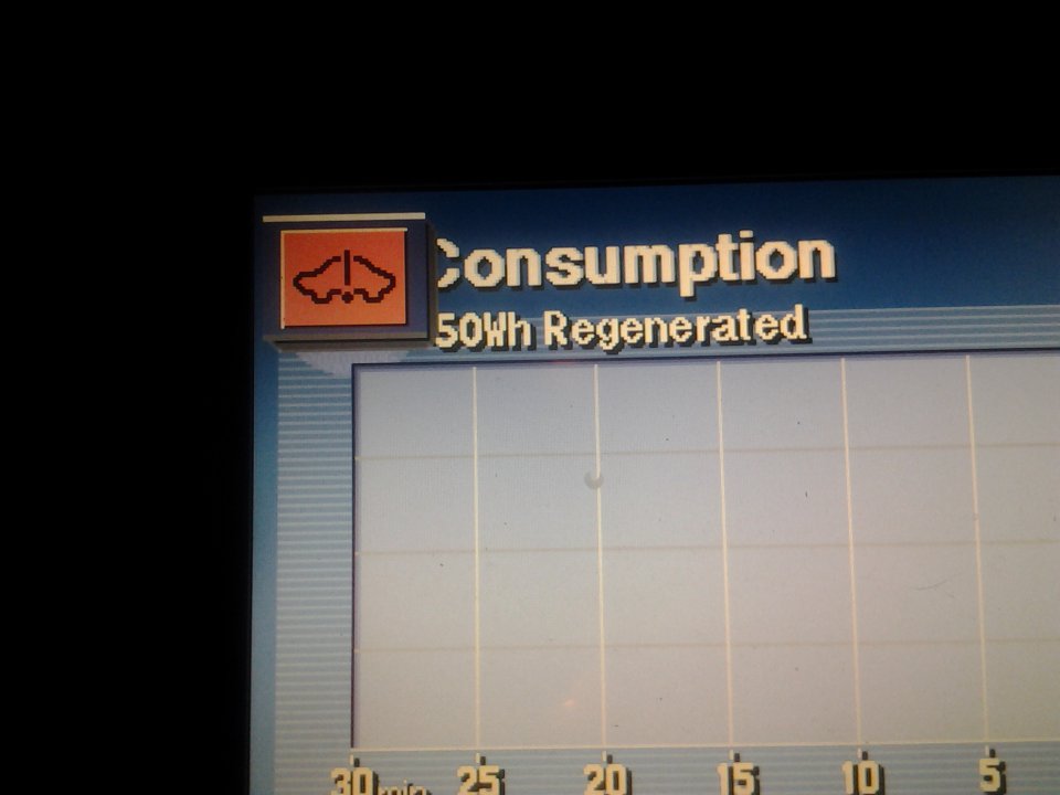

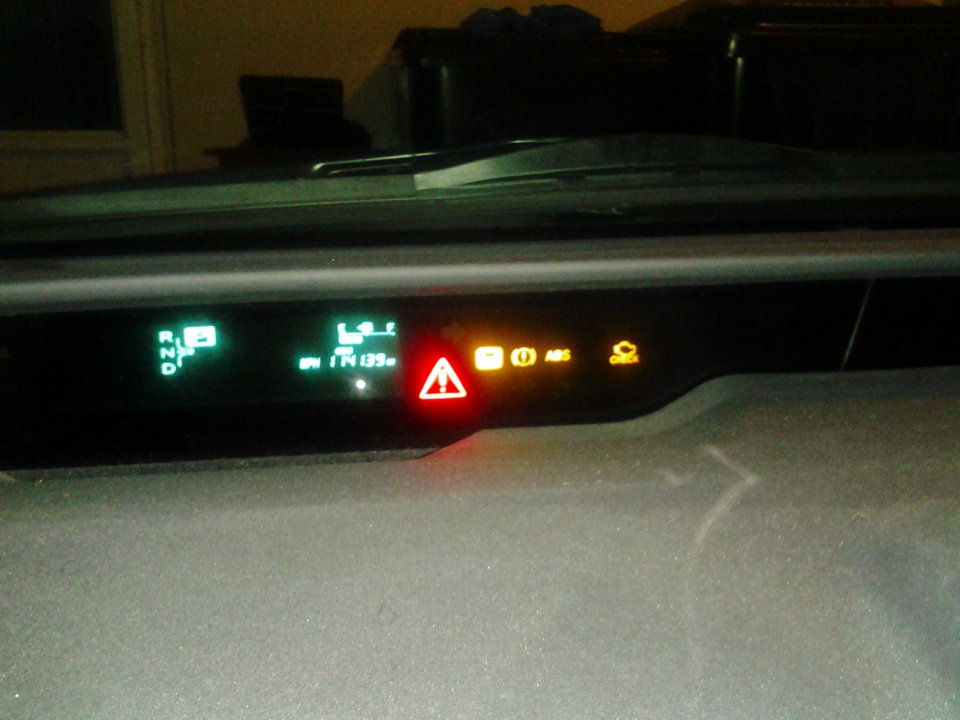

    May 31, 2013
    Here are pictures of the warning indicators. IMG_20130601_052449.jpg IMG_20130601_052429.jpg
  18. Patrick Wong
    Patrick Wong DIY Enthusiast
    Mar 8, 2008
    18,200
    6,472
    Green Valley, AZ
    The first photo shows the hybrid vehicle warning icon. That tells you there is something wrong with the hybrid system.
    The second photo shows the master warning red triangle, which just tells you that something is wrong. I believe the first amber light is the traction slip warning light. The second amber light is the brake system warning light. The ABS and check engine lights also are on. So this shows you that the skid control and engine ECUs have logged DTC as well.
    Therefore, there should be DTC besides P0AA6.
