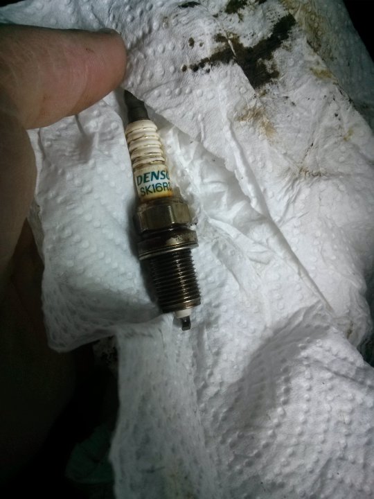

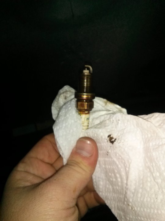

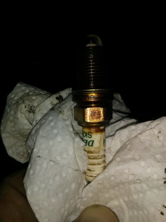

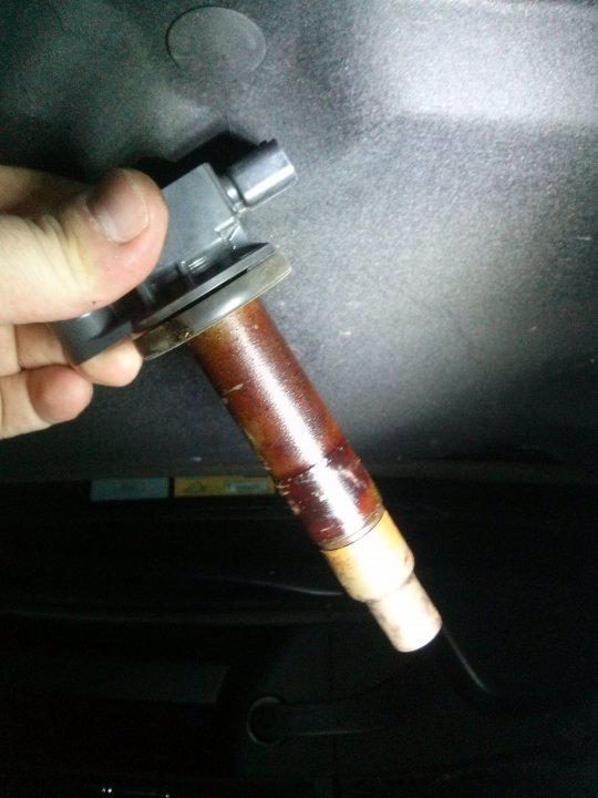

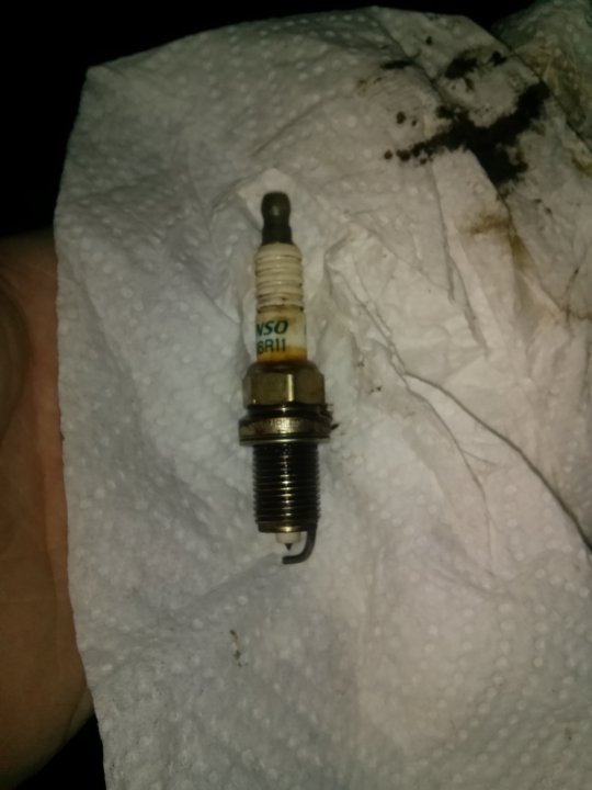

    Update: Hesitation and power loss have returned as of 3/22/2015. I removed all four spark plugs and found that the spark plug on the driver side of the engine, or side closest to the inverter, and its coil pack were covered in dried/sticky oil with no loose oil present around them. Pics added to new post #11 of coil pack and spark plug.

    Well, here I am revisiting this issue since it came back. I finally decided to grin and bear it and removed all four spark plugs to check them to see what the heck was wrong since I had the intermittent hesitation/lack of power again on my way home from work this evening. The only one I found that looked wrong was the spark plug on the driver side of the vehicle, or the side nearest the inverter. The other coil packs/boots were a clean gray color but this one is covered in sticky oil residue and so was the spark plug which I wiped off but at this point my guess is that its safe to say I need a new coil pack and new spark plug? What do you guys and gals think?
    One thing, I haven't noticed any smoke or smell of burned oil coming from the exhaust in the morning when leaving for work. I normally start my car and let it warm up while I move my roommate's vehicle out of the driveway so would think I'd have noticed if I had been burning a significant amount of oil. The dipstick shows I'm at 3/4 up between the min/max marks on it which is normally where I aim for when changing oil. I suppose its possible I may have overfilled on the last oil change but hadn't noticed anything else odd except for this occasional hesitation/power loss lately.

    The question is, where did the oily deposit come from? I would replace the ignitor, but I would guess something else is not right. Injector?

    I would do that but the problem is that its not throwing the check engine light or any codes. I was hoping it would throw a code to match up with my "smoking gun" cylinder but it didn't, not even after I wiped it off and put everything back together and ran for a test drive. Even pushing the accelerator halfway down and beyond, it wouldn't trigger anything to happen other than I could watch the timing advance bog down below 10 degrees and the amps coming out of the battery ramping up to compensate.

    After searching online for why oil may have gotten into the spark plug well, it seems I may be in for replacing the valve cover gasket and spark plug tube seals to fix/prevent that from happening again.

    I'm not fond of the idea of doing that, but I didn't notice any loose oil in the well and nothing soaked up into a towel I pushed into it so maybe it was a single event that fouled the igniter. I think for now I may just replace the coil igniter and that spark plug and give about 500 miles and see if there is any oil buildup on the new igniter and if so, go for the gasket replacement.

    Seeing that spark plug with the burnt oil residue brings back memories from the 70's when that was a relatively common occurrence. The 1600 cc engines had the rubber spark plug tube seals that over time, lost their sealing ability, and looked exactly like yours.
    My guess is that your coil may very well be operating as it should, but I may be wrong.

    If only it would code so I could move it around and see where the problem stayed or went when moving the coil. Unfortunately the ECUs seem happy to just use the battery to make up for the lack of oomph from the engine when I experience these transient losses of power. And it only lasts a few seconds (10-15 maybe) at best and recovers, especially once I'm up to speed or running at a higher RPM uphill.

    The other case I mentioned above the guy had DIY replaced his own spark plugs, and he did not use the correct plugs for the Prius, and one was apparently loose. In your case, we have the correct plugs, but do you think it might have been loose? I am thinking the oil residue came up through the spark plug threads? If so I'd be inclined to just tighten up and see how it goes.

    I hadn't even thought about that, thanks wjtracy! Thinking back, when i replaced this particular one I do recall having trouble maneuvering the socket when reinstalling this one. I did put everything back together after making sure it was tight but the hesitation did come back. So I think I'll replace the spark plug itself first, see if it still occurs and then replace the coil.
