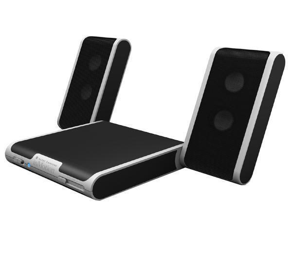

    Well.. thanks for the vote, but considering I'll be at a music festival, I don't think the music will be a problem. =P
    I already have one of these -[​IMG]
    for regular campgrounds & hotel rooms.
