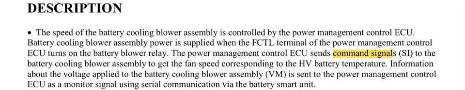

    Gen3 has a variable speed battery cooling blower with pulse width modulation control.

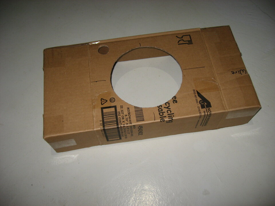

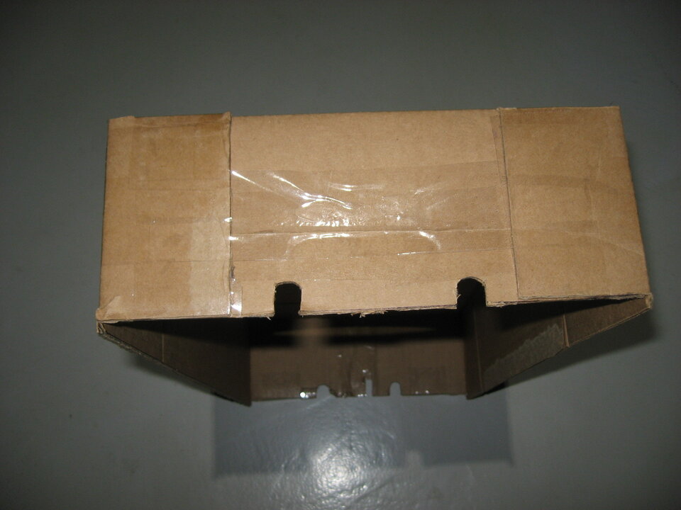

    To prevent the slow degradation of module capacity, I do a once a year deep discharge of the entire pack, in the car. The cardboard box, along with a small fan, keeps the pack completely cold.

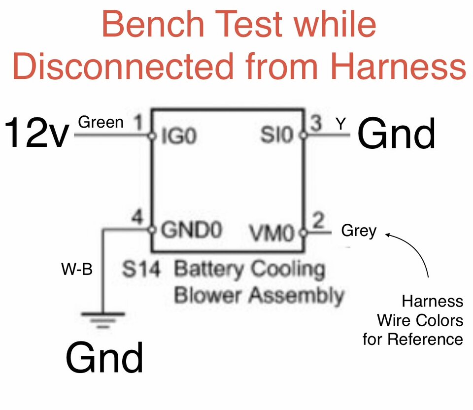

    rj showed the wiring for the gen 3 fan. That SI0 terminal is for speed control, via a pulse train, with the property that the more time the pulse train stays low, the faster the fan. So just tying SI0 to ground, as the "Bench Test while Disconnected from Harness" drawing shows, is enough to run the fan at high speed.
