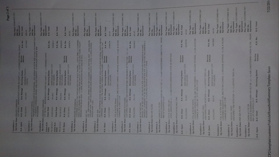

    I will be traveling from Oklahoma City to Vancouver next week with my 2007 Prius and I was wondering what I need to be watching out for. So far the car seems to be in a good condition. It hasn't been giving me any major problems for more than 10k miles since I purchased it 4 months ago with 100k miles on it (not actual mileage). No lights, noises, and shakes. Got brand new tires (Yokohama Avid Ascend) with alignment check which came out good. 12v battery seems to be in a normal range (11.9v to 12.0v with the load on the battery and 12.3v to 12.5v without). Both coolant reservoirs are full and pink (I actually replaced coolant control valve right after purchase). Brake fluid looks like canola oil. Brake pads all in green range. And ultimately, the car runs smooth with 45 MPG with full AC in 90-100 degree heat in Oklahoma City and 50+ without.
    Yet I've recently noticed that it consumed about 2 qts of oil since last service which was done about 3 months and 6k miles ago at the dealer. I told the dealer to put in 4 qts (of Mobil 1 full synthetic "15k warranty" one) and when I recently checked the dipstick was barely picking up oil at the end of it. So I'm assuming about 1 qt every 3k miles. I instantly added 1 qt leftover from last service to have it over the lower dot and am constantly checking the level. So far the levels have been constant for more than 500 miles. But I'm still not sure if it is ready for a long road trip.
    Another thing that I'm skeptical about the car is the fact that the odometer has been rolled back from high mileage. I checked with the dealer to get the service record of the vehicle and last major service was done about 2 years ago with 240k miles on it. Here is a picture of the latest record:
    I knew about the odometer discrepancy when I bought the vehicle but I did not expect such a high mileage. And I have no idea which high mileage maintenance services have been done on it. The record does mention "APPLIES TO 5K 25K 35K 55K 65K 85K 95K 115K FACTORY RECOMMENDED MILEAGE SERVICES" but does not mention anything beyond 115K except major breakdown/repair at 240k. I was mainly worried about trans service, spark plugs, PVC valve and serpentine belt and also throttle body and mass air flow sensor. Both dealer and the former Toyota mechanic who changed my coolant control valve mentioned that the inverter seemed like it was replaced, so I'm not too worried about the inverter flush as of now.
    I don't have a lot of time before the trip and I kind of wanted to save the services mentioned above for later. But at the same time I don't want to damage my car either.
    So what do you guys think? Do you think my car is ready for 3k+ trip as it is now? If not what services and check-ups do you guys recommend that are absolutely mandatory before a 3k+ road trip?

    Sorry I'm confused about exactly what you did or didn't know. Are you saying that the seller informed you that the odo reading was not the true mileage, but they didn't tell you exactly what was the true mileage. Is that correct?

    Yes. That is correct.
